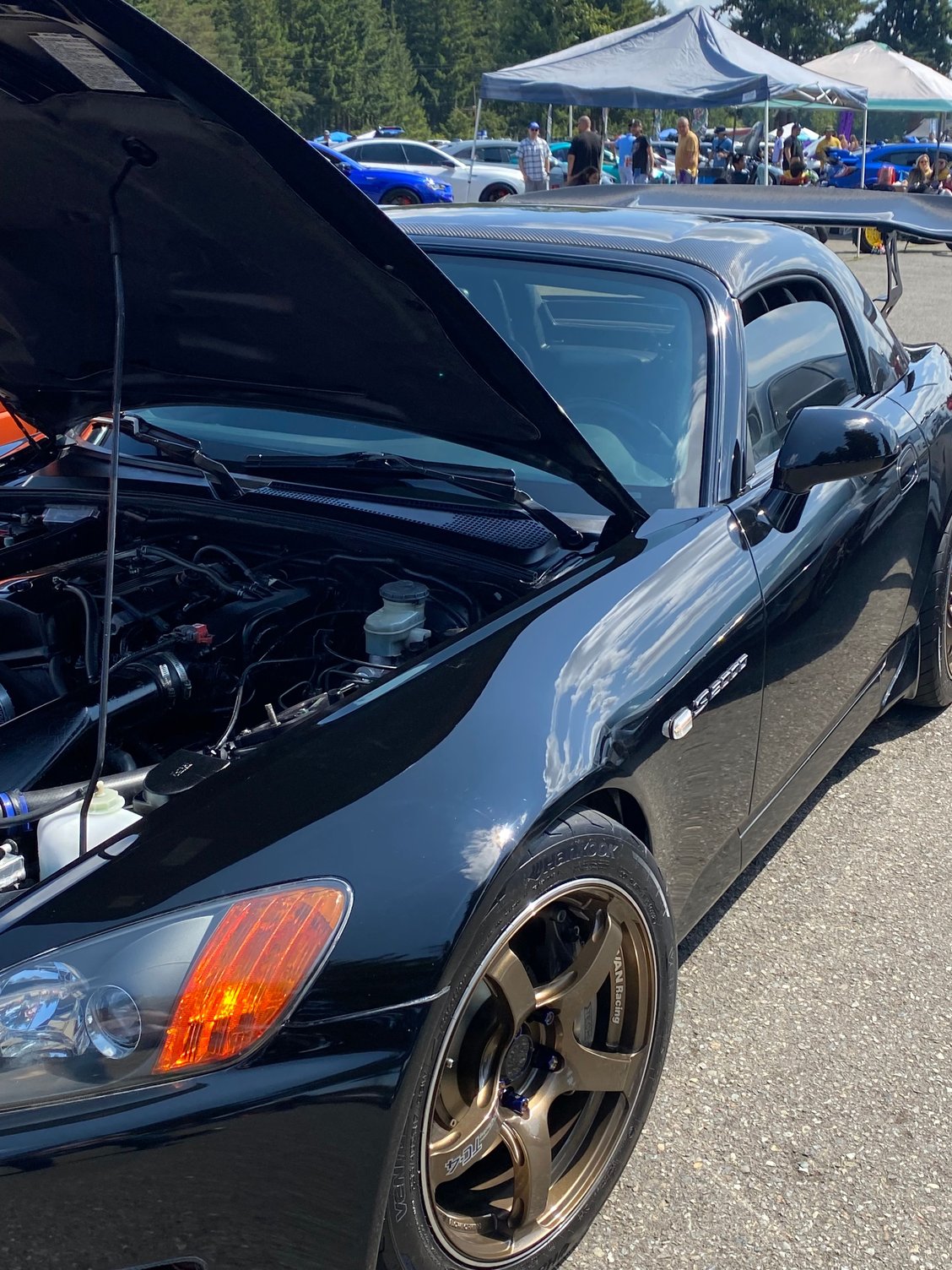

I am running TC-4s in 17x9.5 + 50 with 255's all around on my stock body, lowered on teins ap1. I track the car and both front and rear fenders are rolled. I dont get rub

yup808's Avatar
Joined: Jan 2024
Posts: 3
very clean thank you for the visual reference!

@s2kprax Thank you for the reference this is probably what I am going to end up running at this point. I was only concerned about rolling fenders because the examples I saw at the shop were not only rolled but pulled as well and that made me a bit hesitant but after watching
roll/cut the fenders it made me way less worried about it now.
I'll roll the front and cut the back at this point and go from there. thanks for the tips!
