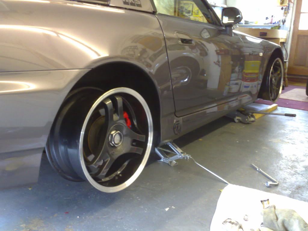

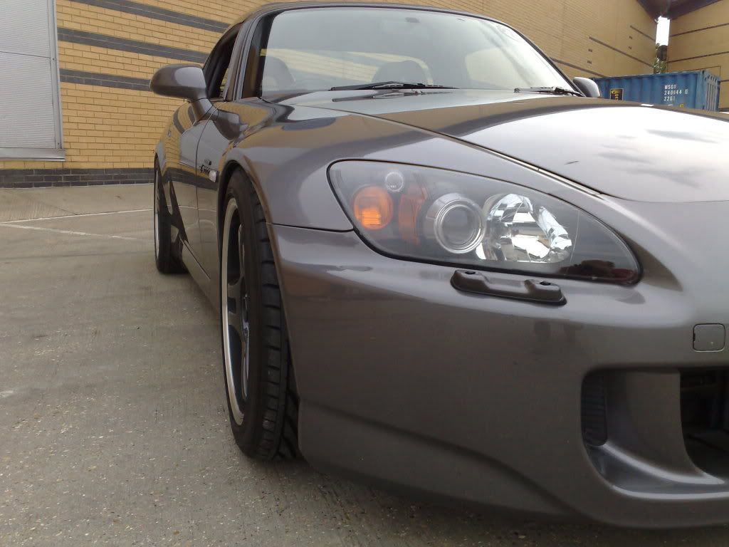

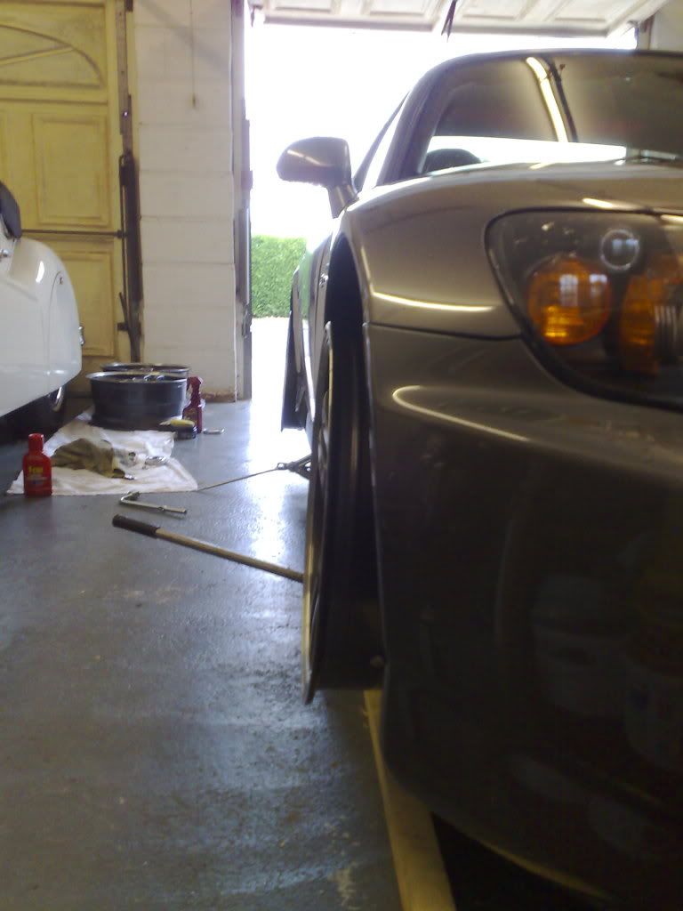

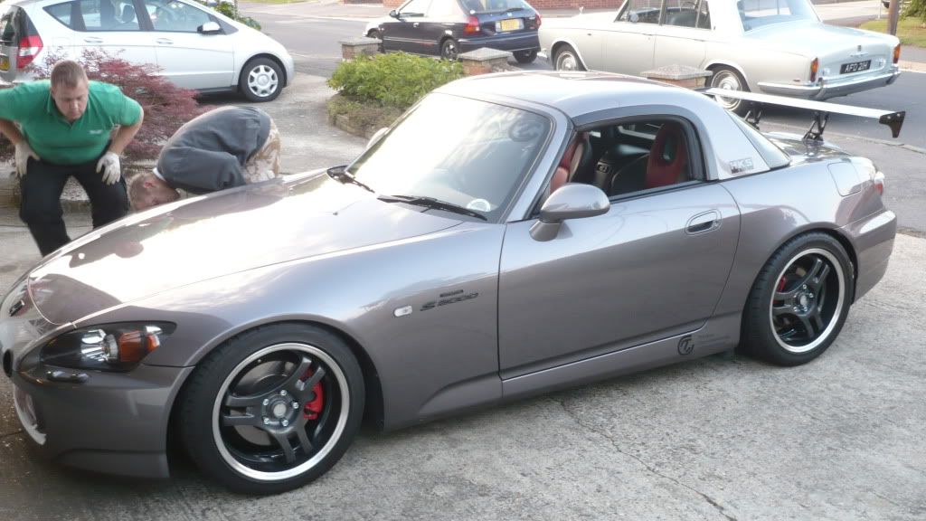

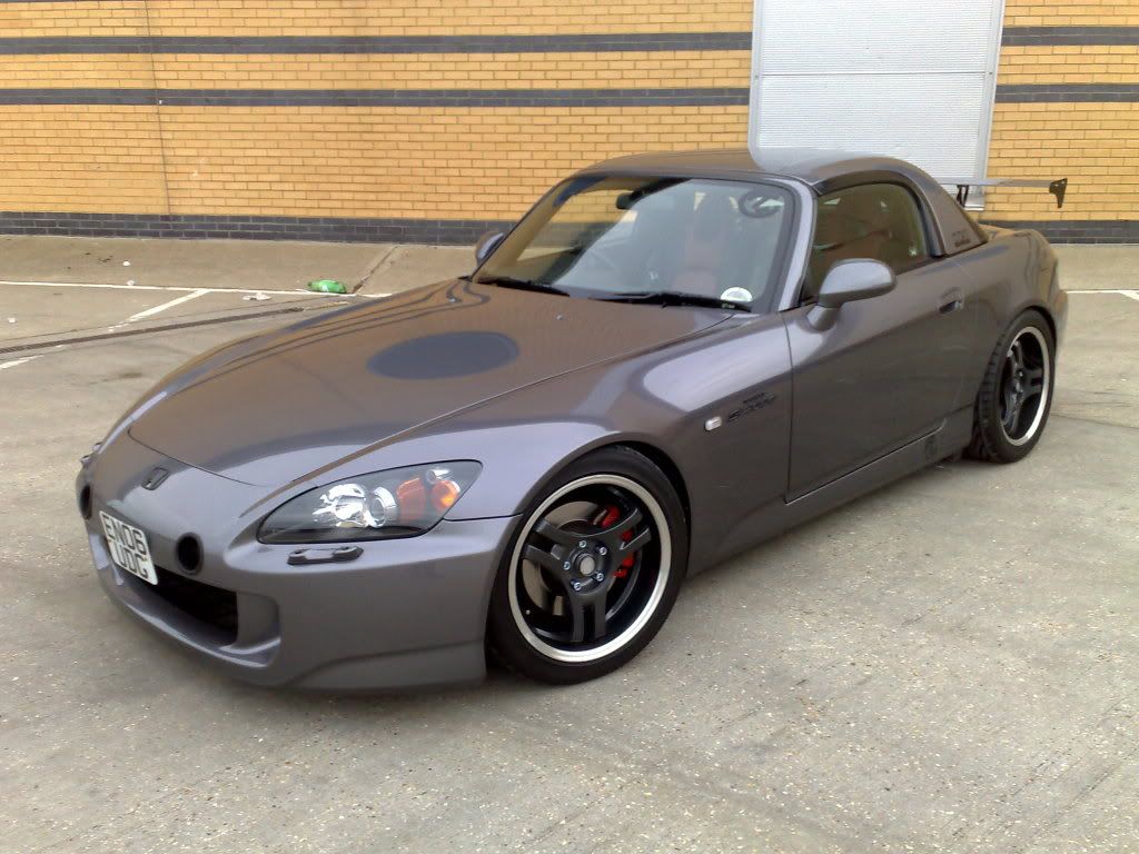

<< Update >>
me and my mate steve decided to try an fit the advans at the weekend, didnt have to many issues it was just a case of new wheel nuts, height adjustment on the coilovers and a slight stretch on my front tyers as my old fronts were 215 and my rears were 245 but there on and im well and truly chuffed with them

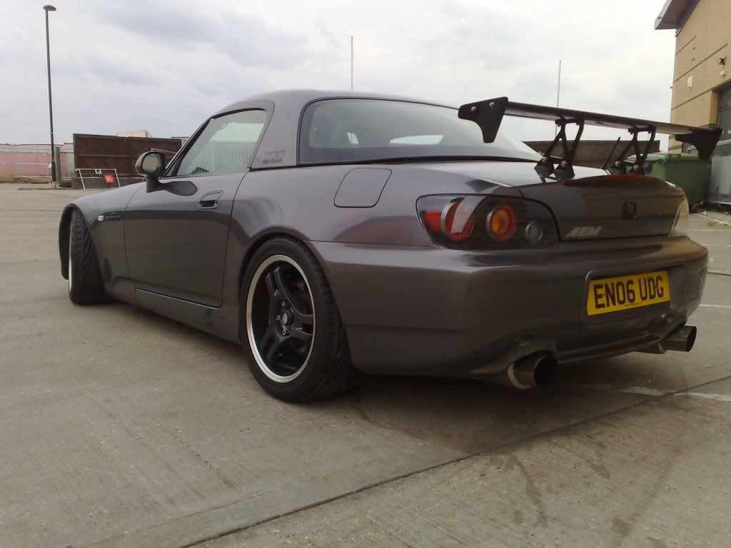

Are those Advan's 17x9 +35 ??
Do you have some more pics ??
Looks good .

Yes mate..
Looking in to getting carbon bonnet, front lip and J'S rear wing
