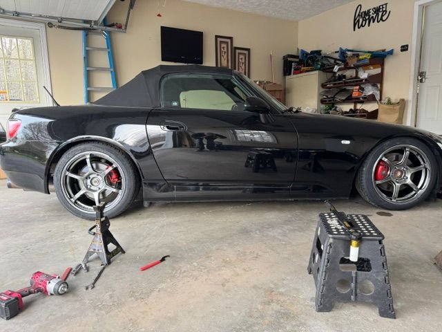

Just recently installed some fortune auto 500 coilovers with a 9kF/9kR spring rate and lowered about and fingergap and a half all around. I still got a staggered setup with 17x8 +54 and 17x9 +63 with a 215/45/17 and 245/40/17 tire setup.
I was wondering if I could get some advice as to what alignment specs I should be targeting with this setup for daily driving/spirited driving while also keeping enough clearance for my wheels without rubbing. Fenders are not rolled and I dont plan on rolling them.
Any advice would help! Thanks!
Currently thinking F: 0 Toe, Max caster, -1.8 degree camber, R: -2.2 degree camber, +0.14 degree toe in total

I run -2.0* F camber, -2.2* R camber , 7.0* caster, 0 toe F and 0.32* total toe in (0.16* each side) R on the street and find it quite good. AP1 btw
