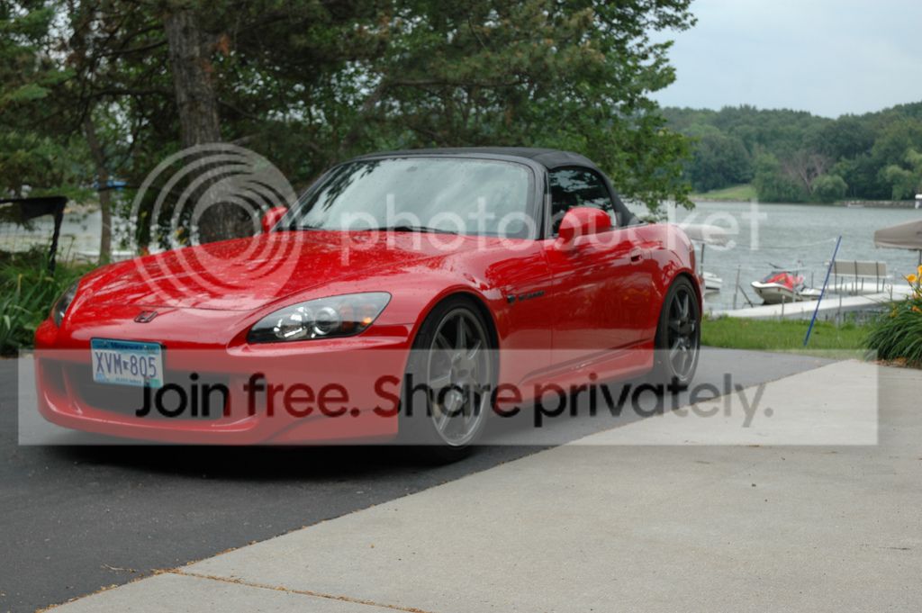

As per the title, does anyone have any more details on the wheels below.. make, model, price, width, offsets etc. They look likd they fill the standard arches very nicely. Any rubbing issues? Available in the UK?

It looks like SSR GT7 or Prodrive GC-07. I believe both wheels are discontinued and you'll have to find them used. The GC-07J is an alternative.

Found the owner of those wheels. Mar48 - SSR GT7

Ah yes, my old wheels on my old S.
18x9 +55 all around.
They rubbed a little when I had about a 1 centimeter gap between the tire and the fender. I added a little camber 2.5 in back and 1.5 in front and I think that eliminated almost all if not all the rubbing. I also trimmed the fender liner.
Was running 245 Yokohama AD07s which I think are on the wider side?
