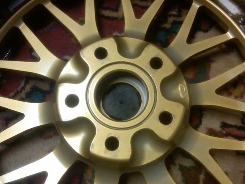

hey guys. I bought a set of wheels and their is play when i install the back. But im sure all i need is a hub centric ring. But the fronts on the other hand hubs are to big for the wheels are to small. I was dumb and forgot to check the hub sizes.
heres a picture at first i thought this was a removable ring? but i didn't wanna mess with it to much.
do you know what i have to do to do?
Thanks

I am not thinking that is a BBS LM wheel. You will have to drill the front wheels larger and then find a ring for the rear.

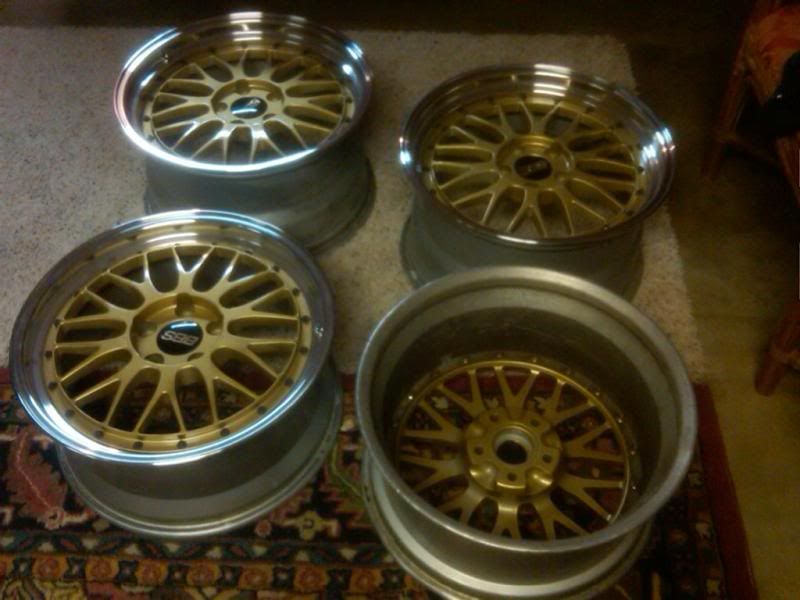

Here they are jim. So basically all i need to do is get the front hub bored?
Old Feb 24, 2011 | 01:03 PM
Mar48's Avatar
Joined: Jan 2005
Posts: 3,477
those look real nice! But yea looks like you'll have to get the fronts bored out... Shouldn't be too expensive, and like Jim said get some rings for the rear

bore the front or just run a spacer.
Old Mar 14, 2011 | 12:58 PM
blueducatikidd's Avatar
Joined: Mar 2008
Posts: 1,840
From: Union Co NJ
I had the same issue with my LM's. I cut that ring out with a flathead and a hammer. That ring popped right out and they will fit after.

ya i had to what blue did. x8.5+38 x10+50.
