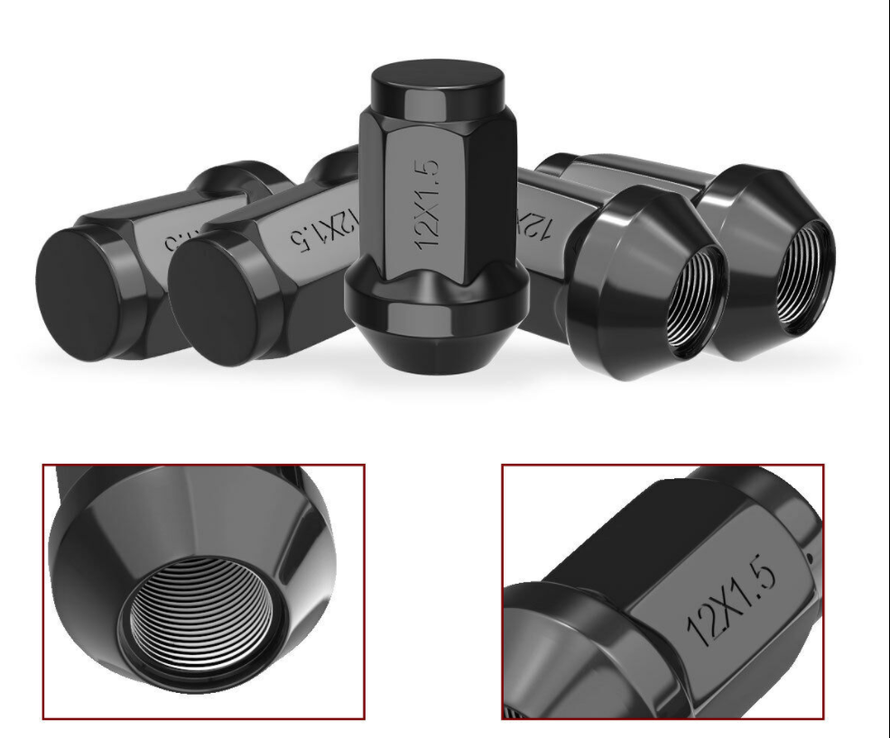

^ Do not use this style of nut. They have a 60 degree conical seat that fits most aftermarket wheels. Apparently, that damages the OEM wheels. Do not use aftermarket lug nuts with a conical seat on OEM wheels.

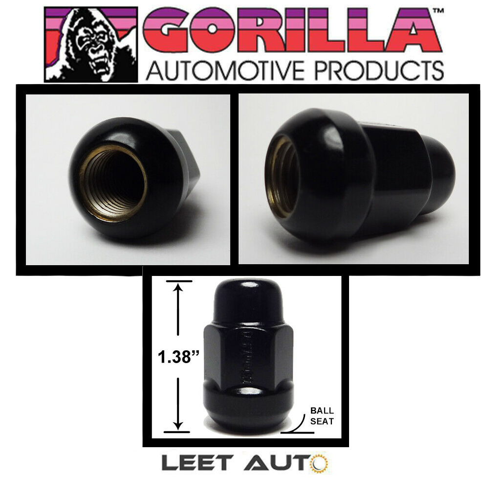

Looks like a ball seat to me...
Gorilla ball seat lugs for comparison.
Some people have no clue what they're looking at.
Taper seat for comparison.
Pretty easy to see the difference if you actually clicked on the link.
I meant to reference the amazon link provided which advertises conical seats. A few people hit the submit button quicker than me.

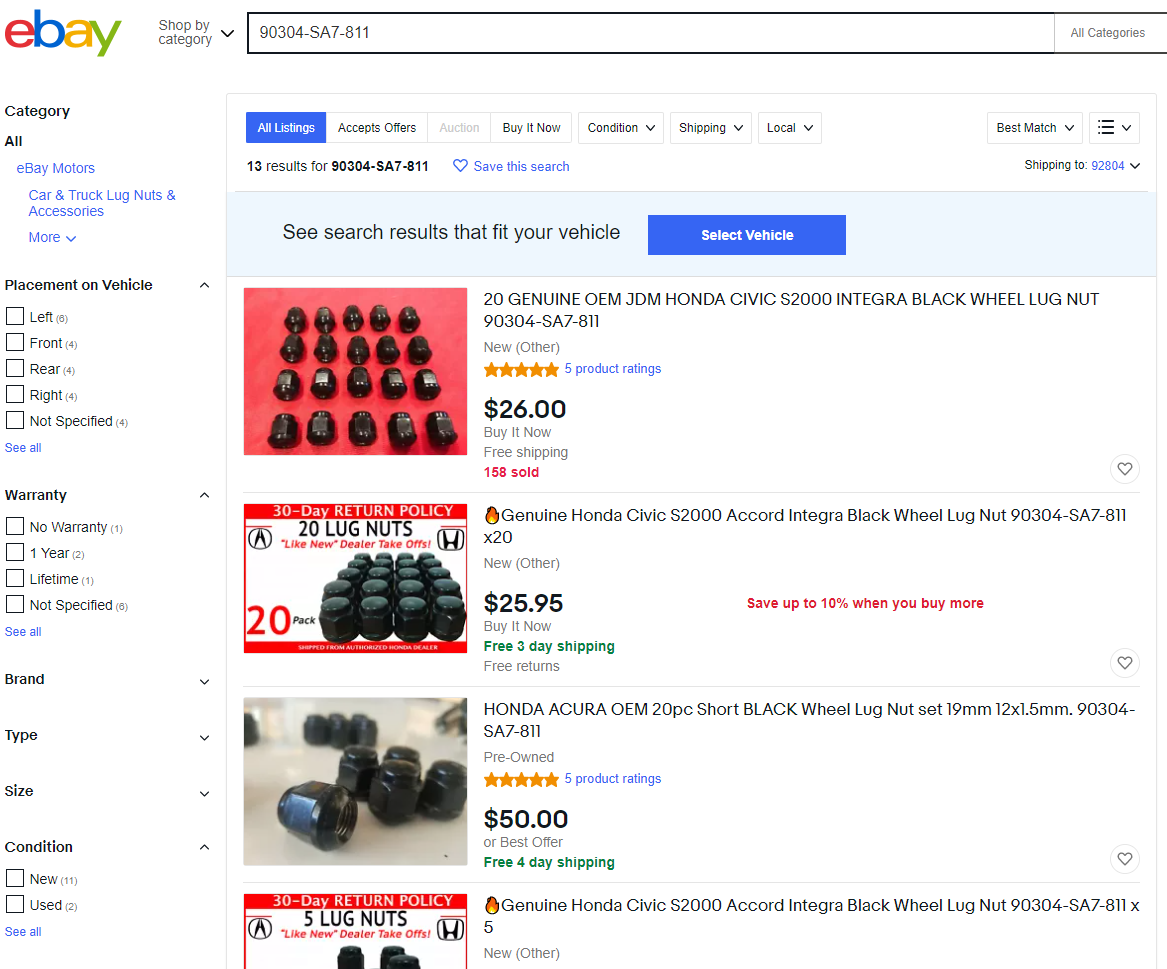

Old Apr 2, 2021 | 12:36 PM
Bullwings's Avatar
Joined: Aug 2010
Posts: 5,092
Likes: 839
For OP - plenty of sellers for the OEM part number on ebay.
https://www.ebay.com/itm/20-GENUINE-...75.c101224.m-1
confirmed ball seat for use with OEM wheels.
Plenty of returns if you type the part number in to ebay search.
