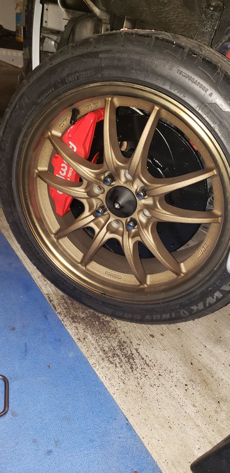

I had my tires and rims mounted and balanced. Each wheel and tire combo has balancing weights installed on the inside barrels, with one row of weights closer to the outer open edge, and one row close to the hub/spoke edge. I have a Wilwood BBK on the car and the calipers are hitting the inside wheel weights. I'd rather not put the weights on the outside of the rim but that will be a last resort if necessary. I asked the tire shop if we could put the weights on the inside of the wheel spokes sitting vertically and they said no they have to be horizontal on the inside of the barrels. I can't believe the clearance was so tight on the brakes in that regard, they clear everything but the wheel weights for god's sake

pic below, I would say the height is over 1/4 inch with the sticky tape. So the line of weights closest to the spokes is the area that contacts the Caliper. Pic of caliper below as well. I don't see why affixing them to the base of the spokes on the inside of the wheel would cause an issue, I read somewhere you can put weights on the spokes, but who knows.

Just so we're all on the same page, what dimension needs reduction? Common, standard wheel weights are 1/4" High. Would something less High fit? Or a thinner Width as in some designed for the lack of space on a motorcycle wheel? Length is usually what's adjusted to get the exact weight needed with the length separated at break points.

Thanks Chuck, the issue is the Height - H, it is too high and contacts the front of the caliper as the tire rotates, cutting it down in 1/2 would be needed but if better if eliminated . The rest of the dimensions are fine.

These claim to be "ULTRA-SLIM LOW PROFILE DESIGN. 0.25oz weight, 0.12"(3mm) Thickness is For Easy Contouring& Preventing From Scraching (sic)." That's half the thickness of what you have now. But you'll need twice as many of them.

Thanks Chuck I will check those out for sure, if they are about 1/2 the size that may just work. Thanks Kindly
