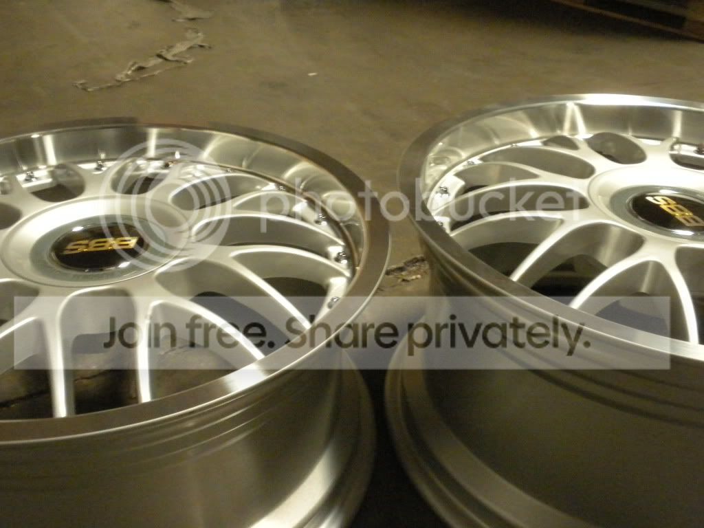

They are an uber-rare and discontinued rim made by Stern for BBS back in 1996. I found a tuner shop that had bought them back in 1997 and put them in storage brand spanking new! They must have been tight on money because they put 3 sets up on ebay. If you google "BBS Stern" you will see how rare they are. Only one set ever sold on here...
They look a lot like BBS LM only the center + lugs get covered by a cap:
So stoked to put them on. Lugs should be here today or tomorrow. Gonna need suspension to get them to not look funny. Pss9 will be ordered in next couple days.
