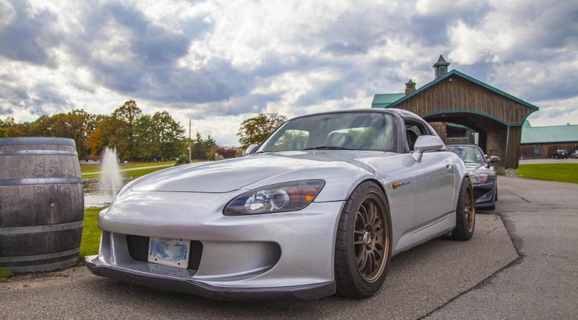

I have that exact wheel spec using a 255 tire. No rubbing.
My fenders and rolled and slightly pulled. Running 2 degrees of camber and about a 2" ride height drop as well.
Only picture I have. This was with 1 degree of camber and I didn't rub unless I hit a big pot hole. Added camber and it was all good

Rears are 255/40/R17 RE-11A's pretty much brand new when I took this pic
