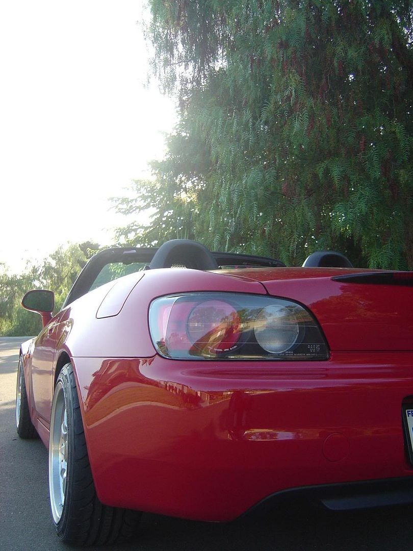

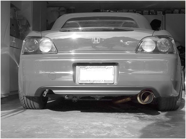

that is how it looks. with stock height you can run a 245 in the rear 215 up front. lowered you should have 215 front, 235 rear if you do not have rolled fenders. with rolled fenders you will have enough clearance to run a 245.

silentdancer--is your car lowered in that pic? if so, what kinda suspension? how many inches dropped?

the 1st pic i was dropped to no finger gap front and rear. the 3rd pic i was at 2 fingers front and rear. im not sure how many inches though. im on JIC FLT A2's
