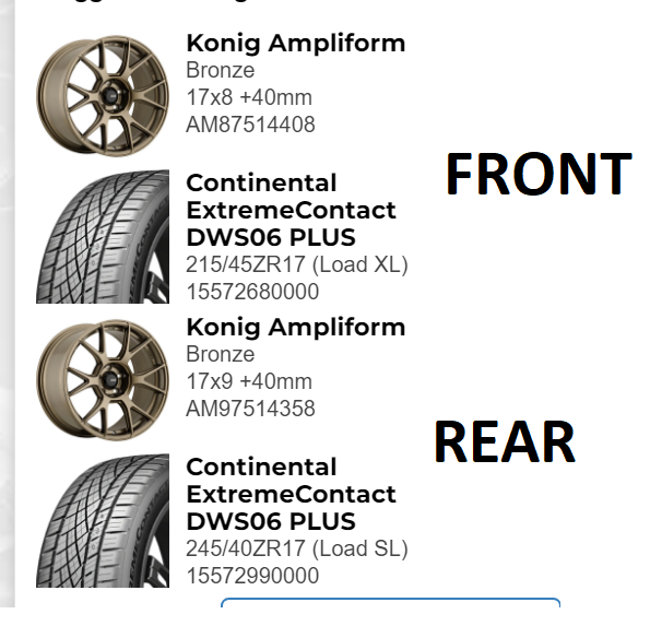

I've done alot of Googling and reading through he fitment guide but I keep seeing all sorts of info regarding different sizes and it's starting to make my head spin. Granted, I'm not very knowledgeable about wheels so I'm sure that isn't helping me.
How would this set do? Essentially I'm looking for an upgrade to my AP1 wheels (OEM+?). I want to avoid any need for fender rolling or modifications. My 03' is bone stock. Thanks!!

Those would need rolled fenders. You need to be over +50 on the offset to avoid rolling fenders.
if you want oem+ just get some oem ap2 wheels or there are the rep ap2 wheels that have good reviews from people here.
