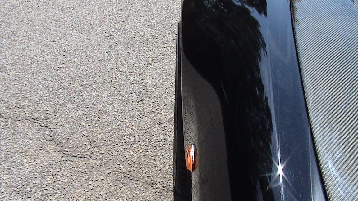

Before I bough t my rotas I did alot of research on sizes, offsets and, quality, and what they looked like. It seemed that a good number of other people were also looking for the same info, so i hope this help.
I bought a staggered set, 16x7 in the front and 16x8 in the rear from jlb motorsports. I ran 225/50/16 in the front and 245/45/16 in the rear, but after seeing them installed I think they would look better with a 45 and 40 series. I am not lowered so i don't have and rubbing issues, but if i was i definatly would. But a smaller tire combo and rolling the fenders should fix that i think. The sizes are 5x114.3 +45mm offset (FRONT) and 16x8" 5x114.3 +48mm offset (REAR).
well tell me what you think
Interesting that you don't have rubbing issues. I'm thinking about getting the Spoon SW388's in the same sizes (except +45 offset in the rear instead of +48). According to the "Wheel Fitment Guide" stickied thread, the minimum for 225 tires is +53 offset:

thanks man, I don't do any track or anything so I for everyday driving they should be fine. I dont have any problems now, but its close, even a 1 inch drop would give me problems though.

Looks good. I think Im going to get a set of these when it comes time to mount summer rubber next year. I like the way they sit pretty flush with the fenders when viewed from above. I'd probably go with the gloss black or gunmetal tho. But whatever, they look really good!
