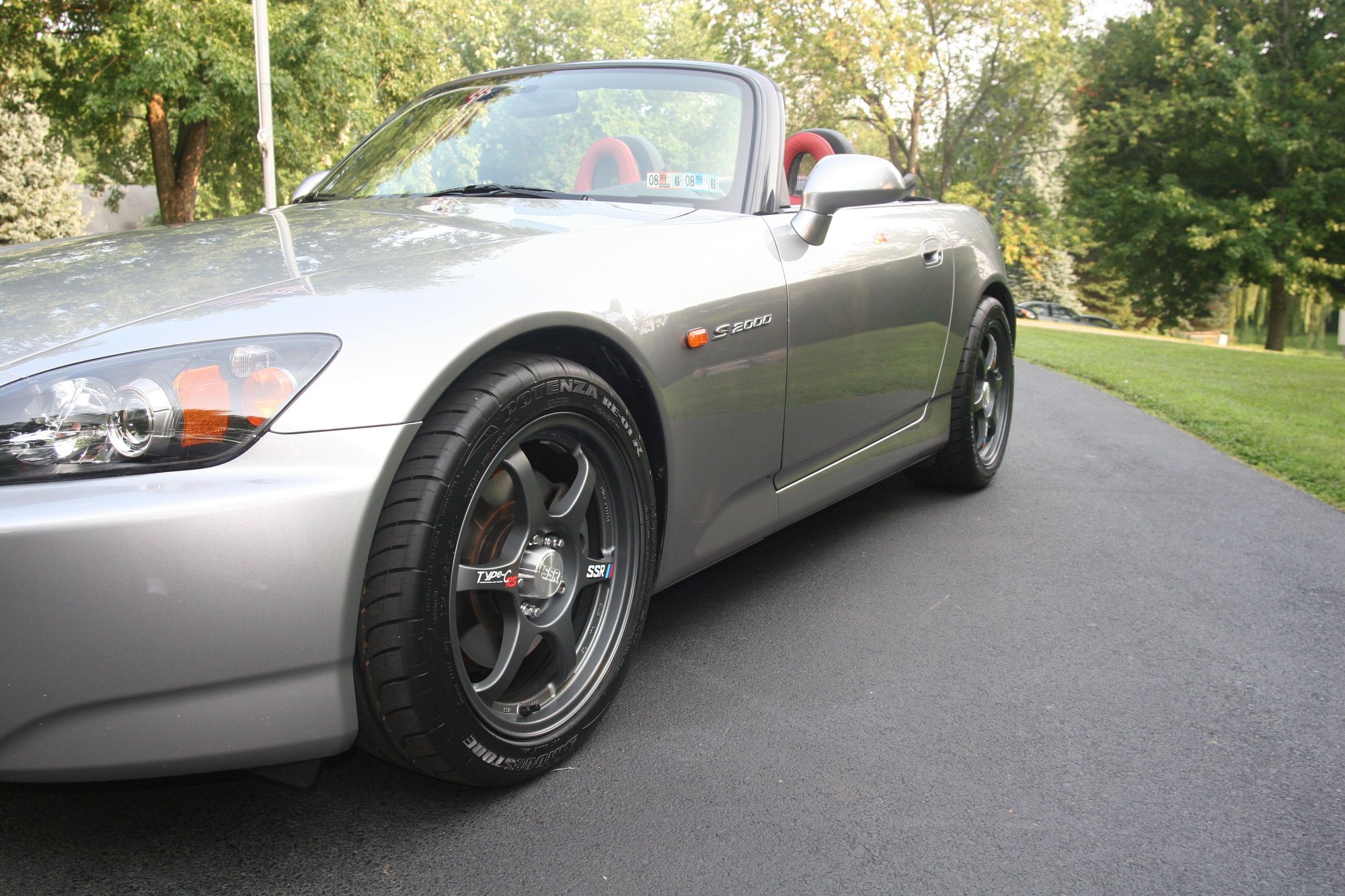

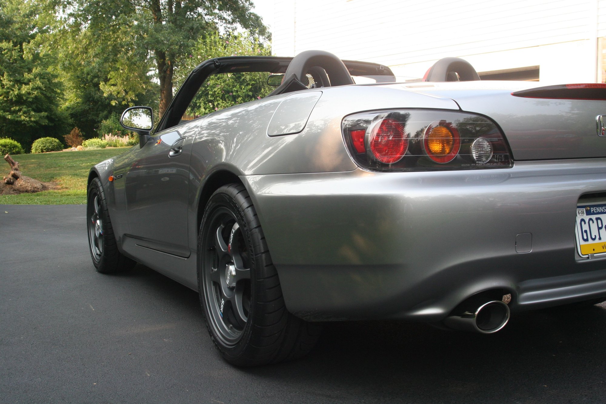

My car is exactly the same as yours, my recent purchase from Tire Rack was the SSR Type crs wheels with the RE-01R tires. 225/45's up front and 255/40's in the rear....... in a word......Superb !!! By all means DON'T go with a 205 up front !!

twitch, any more pics? Are you lowered?
Nope, other than wheels and tires the car is bone stock, with only 4800 miles on her. Never seen snow and only once was I caught in the rain !!

looks good.. but the SSR's in 17 look a bit small for my taste..
