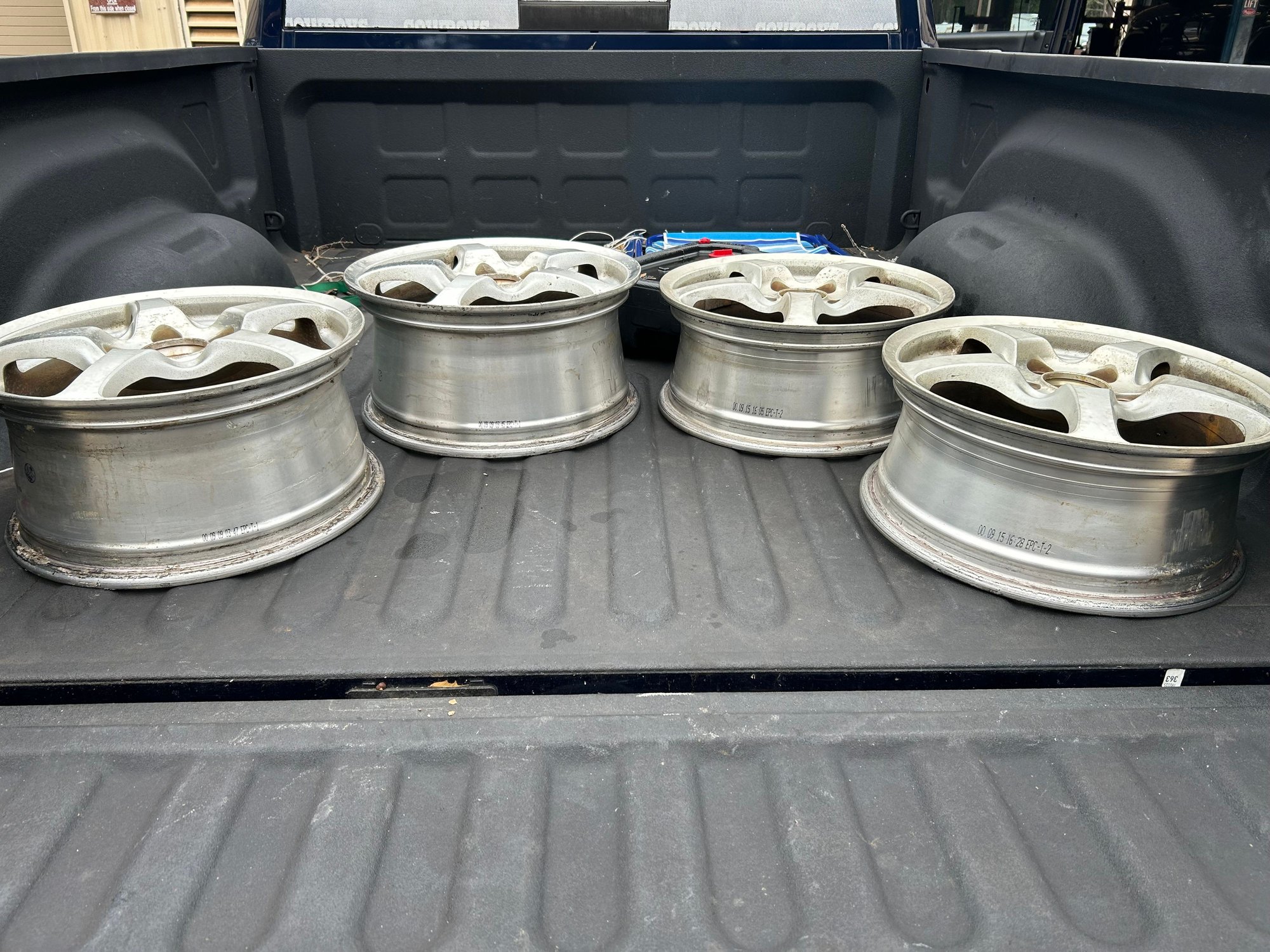

I decided last week that I was going to order a set of re71s and run them on my ap1 wheels for my autoX setup.
im in the process of refreshing my wheels before I wrap them with some fresh rubber.

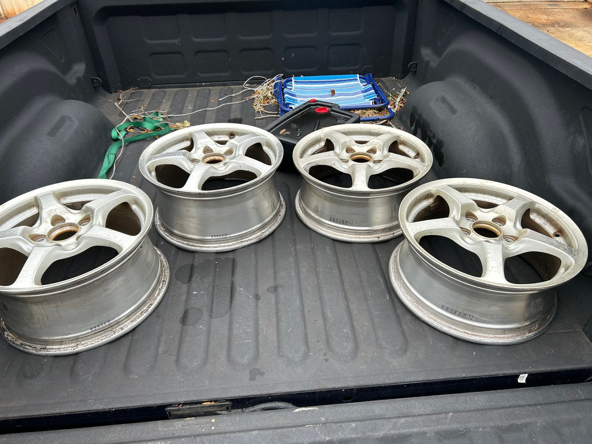

Went by the shop and stripped off the beat up Kelly tires that I trashed.
If you zoom in on the drums you can see the manufacturer date stamp.

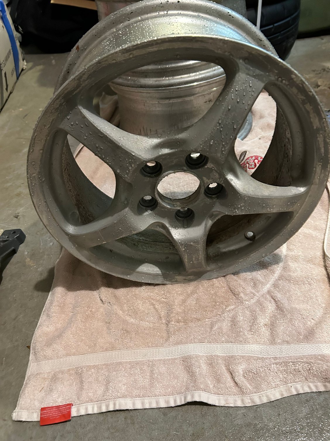

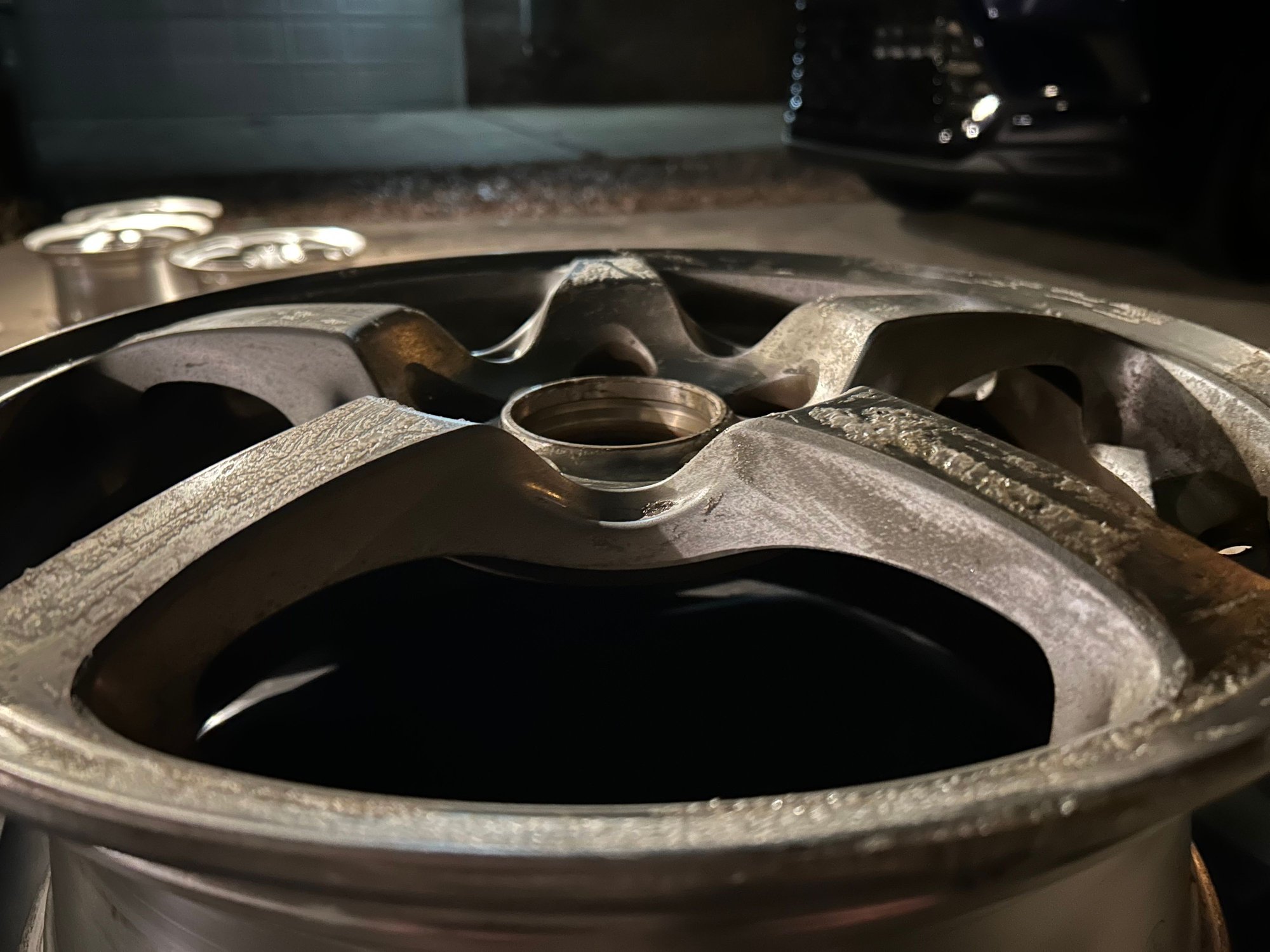

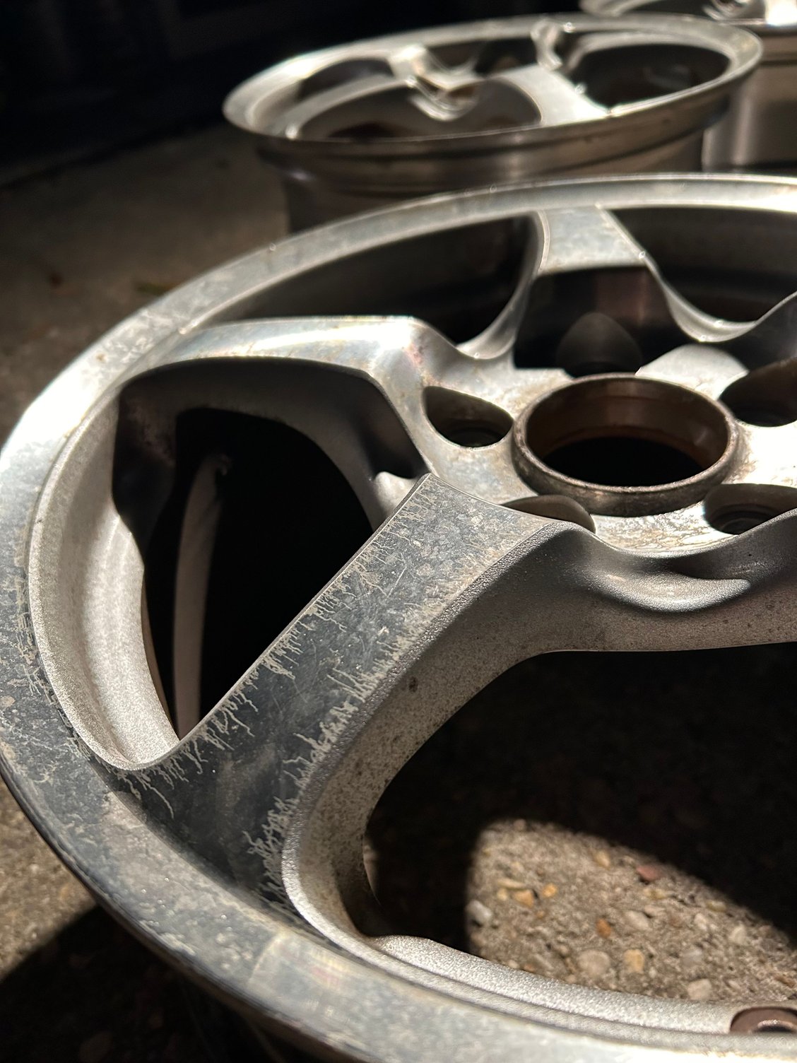

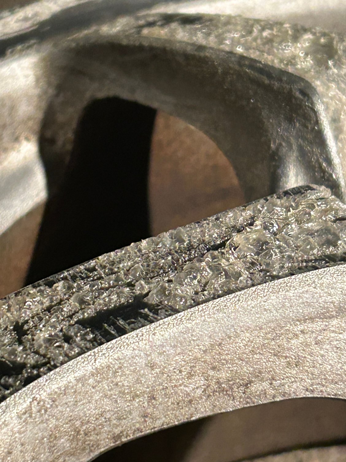

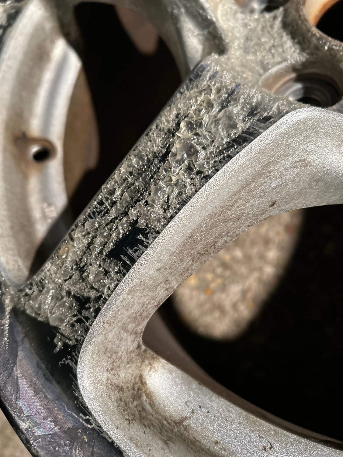

I had planned on media blasting the wheels to prep them for paint but my buddy Mike recommended using a product called aircraft stripper to dissolve the plastic like clear coating that is on the face of the rim. He said the media would have a hard time getting through it on its own.

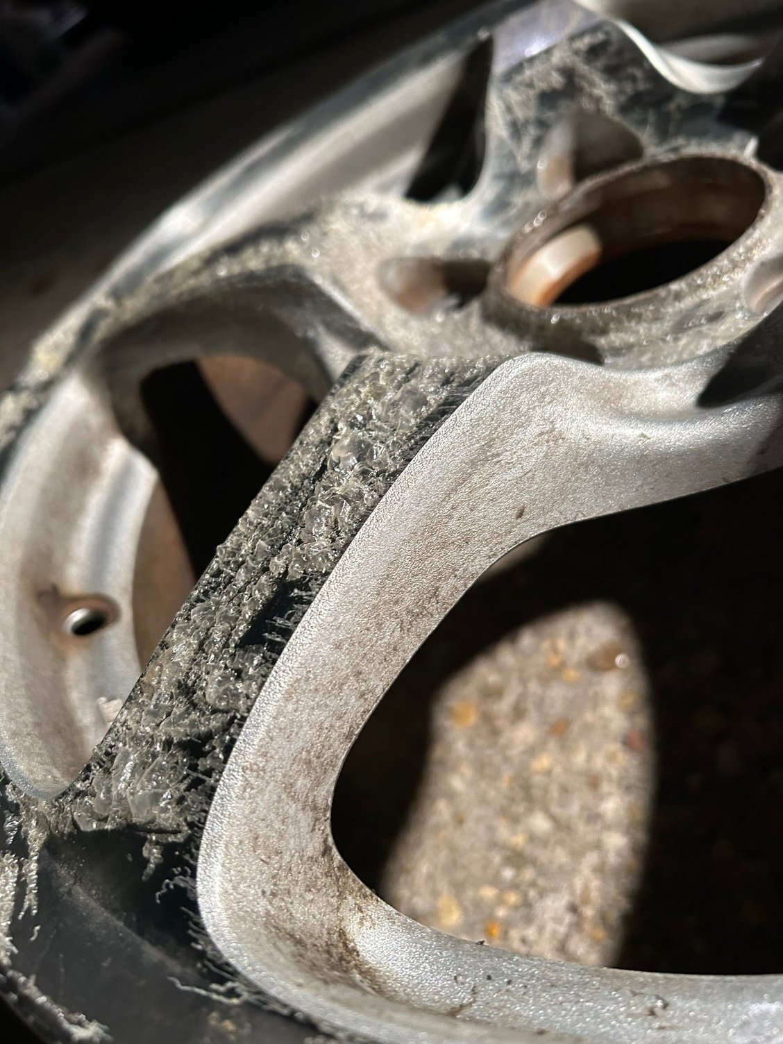

Here you can see that product starting to work after only 10 min. It’s winter here in FL so it’s about 60 degrees out in the picture.
You can see the spidering that is happening under the coating.
From far the wheels didn’t look bad but they can certainly be better
More detail
Product is pretty effective
First time using it but so far I’d recommend it.

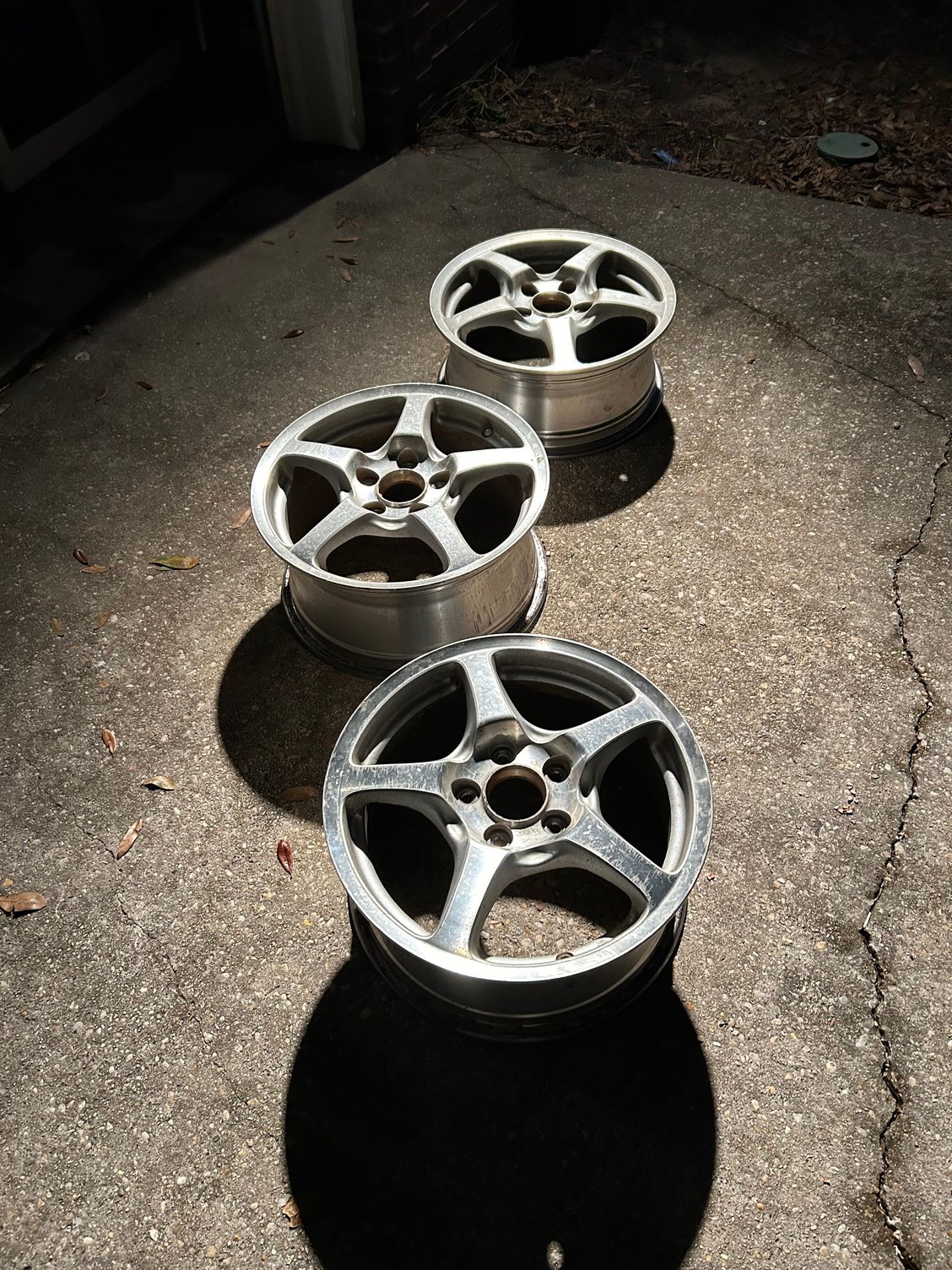

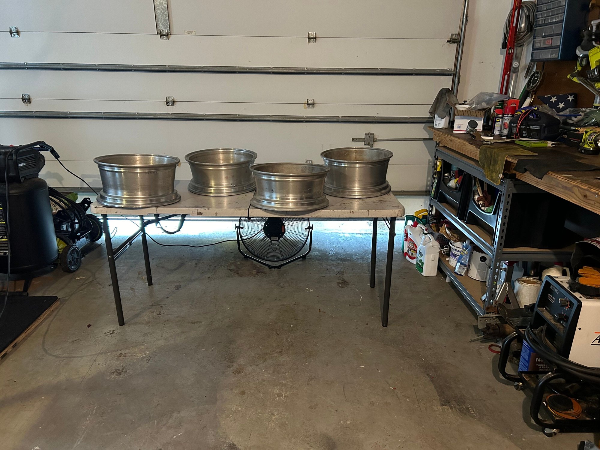

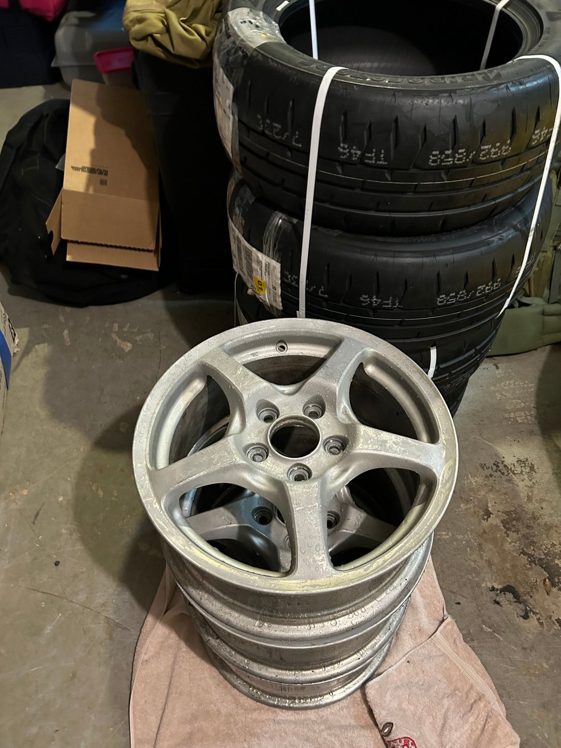

Spent another hr at the shop today, wheels are stripped down, I’ll sand them today and get them ready for paint. It’s raining today so I probably won’t get any color on them
Still wet from the rain but they came out pretty good
I kind of like the raw finish. Too bad they would look like crap after a few drives

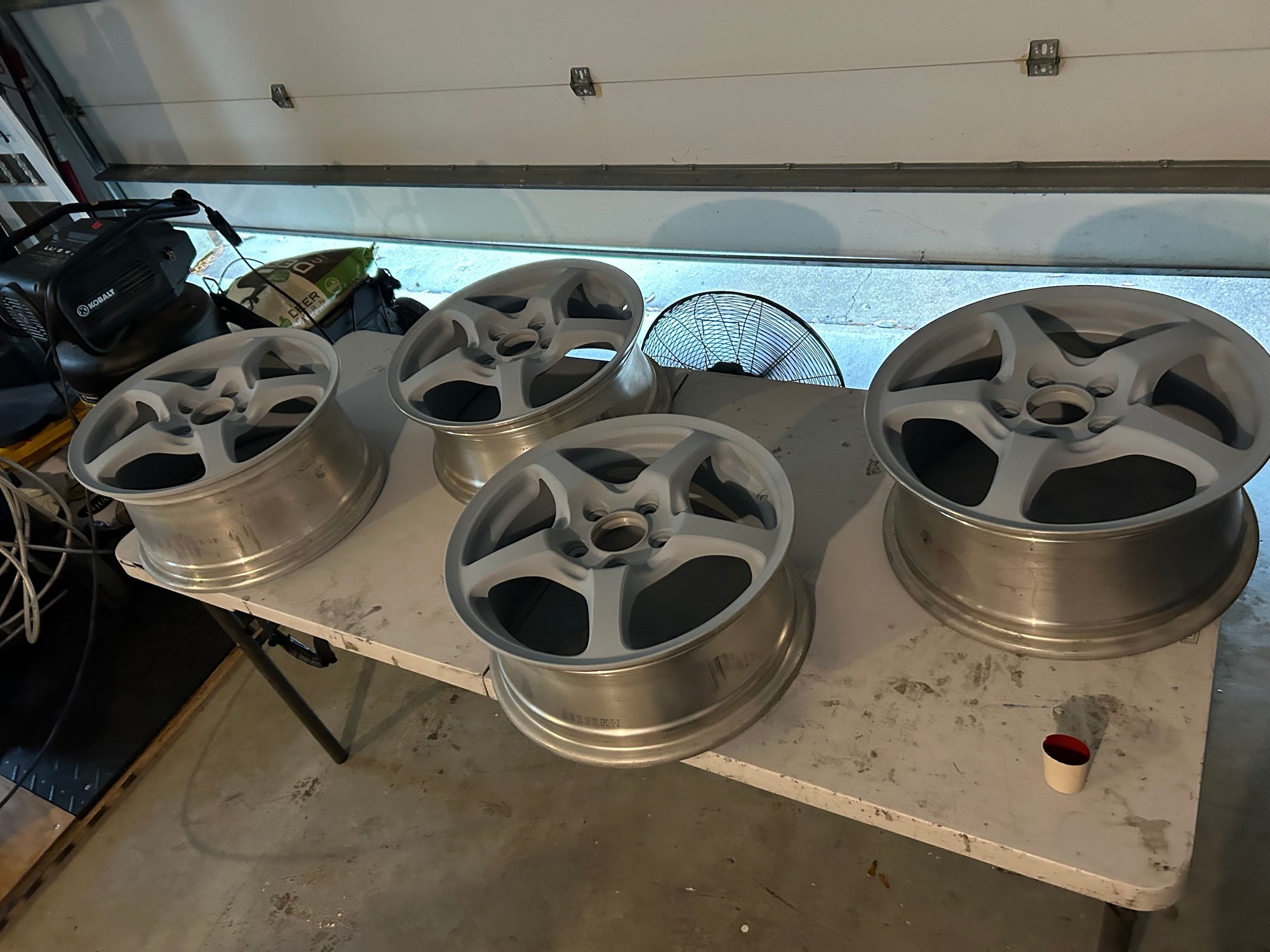

Makeshift down draft paint booth.
Old Jan 27, 2024 | 02:43 PM
Dibsen's Avatar
Joined: Aug 2023
Posts: 800
Likes: 277

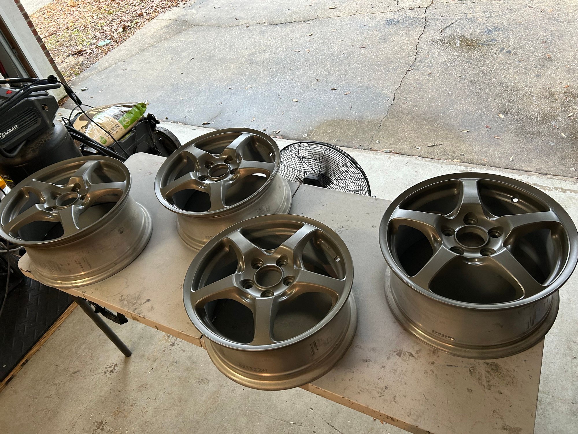

not perfect but for around $50 and about 4hrs of time I’m happy with them
Not perfect but better than what they were before

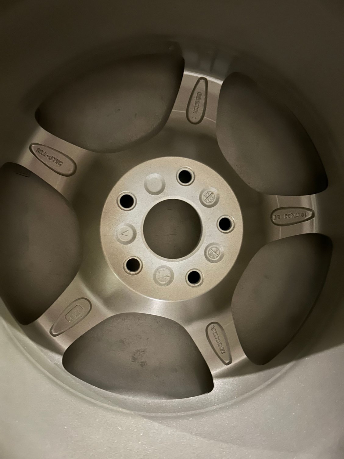

I like the details like the wheel size, Enki, and Honda stamped on the backs
now to get the rubber wrapped on em

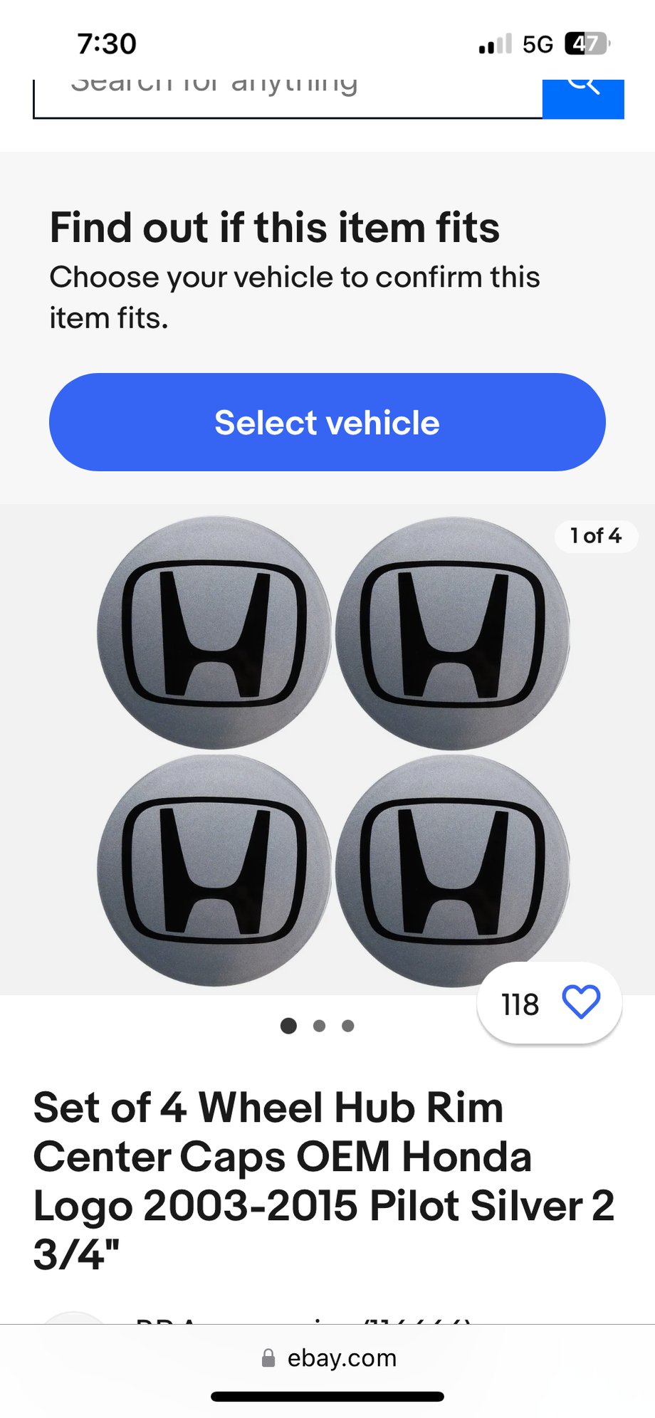

Anyone know if these would fit?
Old Jan 28, 2024 | 05:19 AM
Chuck S's Avatar
Joined: Jul 2014
Posts: 13,826
Likes: 1,548
From: Chesterfield VA
Probably will not fit. And they're not 2000-2003 S2000 wheel cap anyway. Different H. Search with Google with part No. 44732-S2A-A00.
Probably find them on Ebay -- they ain't cheap but you spent hours refinishing the wheels and put $1,000 worth of tires on the car. Why cheap out now?
-- Chuck
Old Jan 28, 2024 | 09:36 AM
Dibsen's Avatar
Joined: Aug 2023
Posts: 800
Likes: 277
-- Chuck
Thabks Chuck, I’m going to paint them to match anyway so I’m not going to send the $$$ for mint caps.
if anyone has an extra set laying around shoot me a pm.
