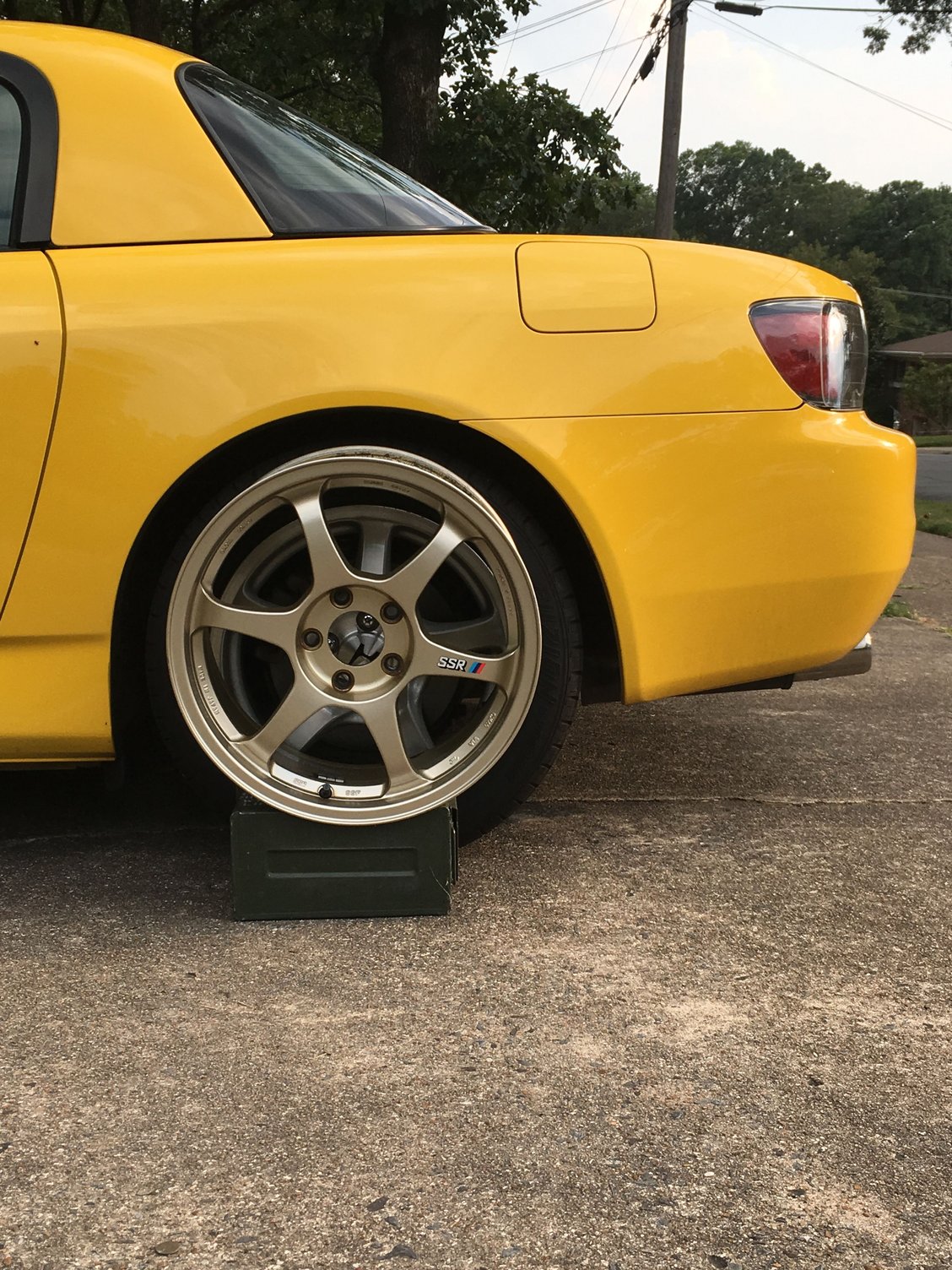

Just arrived. Thanks guys!

Nioooce!

Yeah I really like those OEM wheels, but snagged the SSR’s for a good deal so I couldn’t resist!

Why do some of the pictures show 5x100 stamped on the wheel?
Old Aug 2, 2018 | 04:35 AM
JDMdoode's Avatar
Joined: Jun 2017
Posts: 98
Some wheel companies that have wheels in various sizes leave the first few PCD on the wheel to save money. Worried me at first as well!
