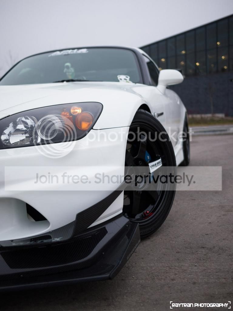

I can help on this one! Partially rolled rear with 255/40 Continental DW all arouund. -2.8 R and -2.4 F with Downforce fenders. You can pull your fronts and get them to fit. Maybe run a 245/40 in the front if you have to but it's doable.

Yes they will work with rolled and mildly pulled stock fenders.
