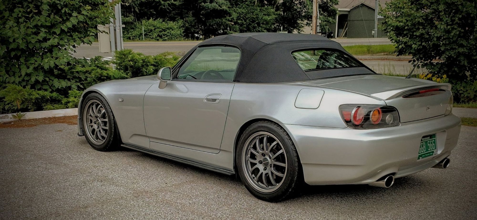

Picked up a supercharged s2k with a claimed 315 whp. Previous owner had 255/40 on the front and 275/40 on the rears. The front wheel size is 17x9 and the rear is 17x10. Should I stick with the sizing or change it. The rear tire is 2% larger in diameter than the front

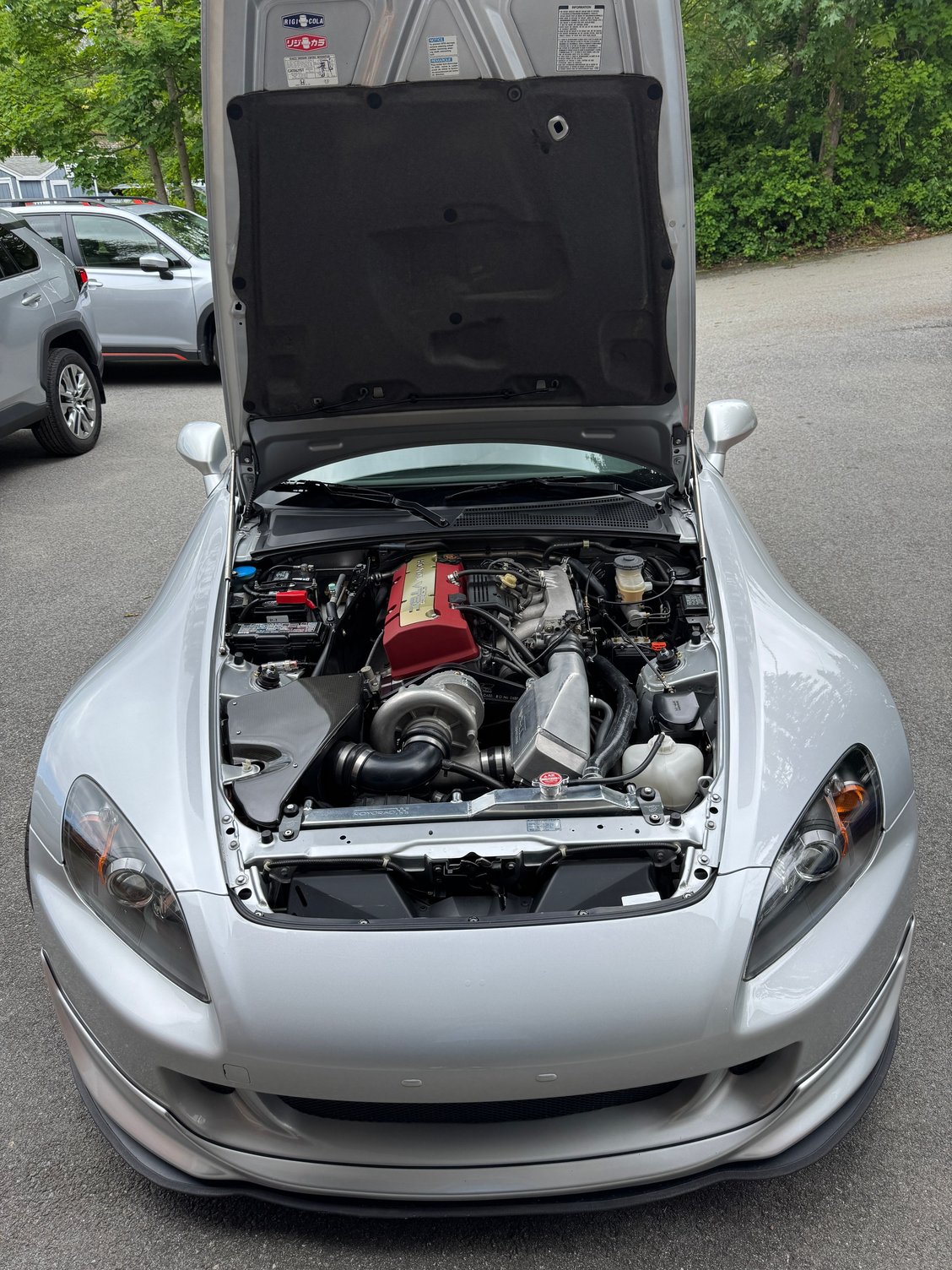

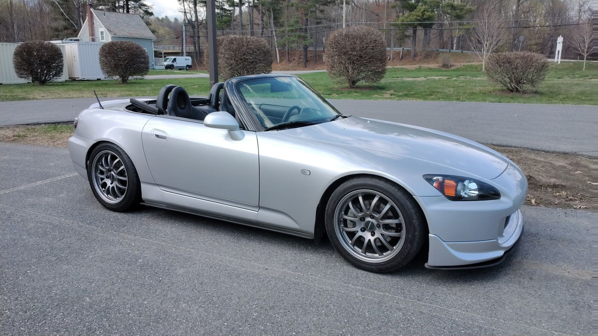

it’s on 949 wheels, fenders are rolled and it on bilsteins. Ended up going with continental ExtremeContact sport 02s

Supercharger (and the car itself) look clean.
