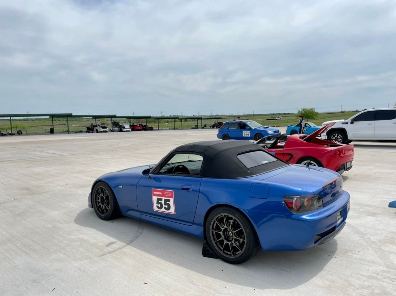

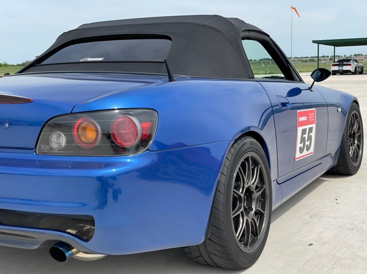

Well both the TC105X and TR10 are similar being thin 10 spoke wheels. I think this style of wheel does suit the S2K well though. The TC105X is also available in 17x9.5+45. Though I've read that BBK fitment is actually not very good with this size due to the more concave spokes. Also the +45 offset would be harder to fit and probably require a fender pull.
I'm biased towards the TR10 as I own a set; I'll take the opportunity to whore my car around any chance I get, pics below. I also did compare the two wheels and I ended up liking the TR10 more because of the 9.5 width spec and the slightly more concave spokes it has. My previous set were also 9.5s so I didn't want to go back down to a 9 for more squished side walls.
Attachment 141577

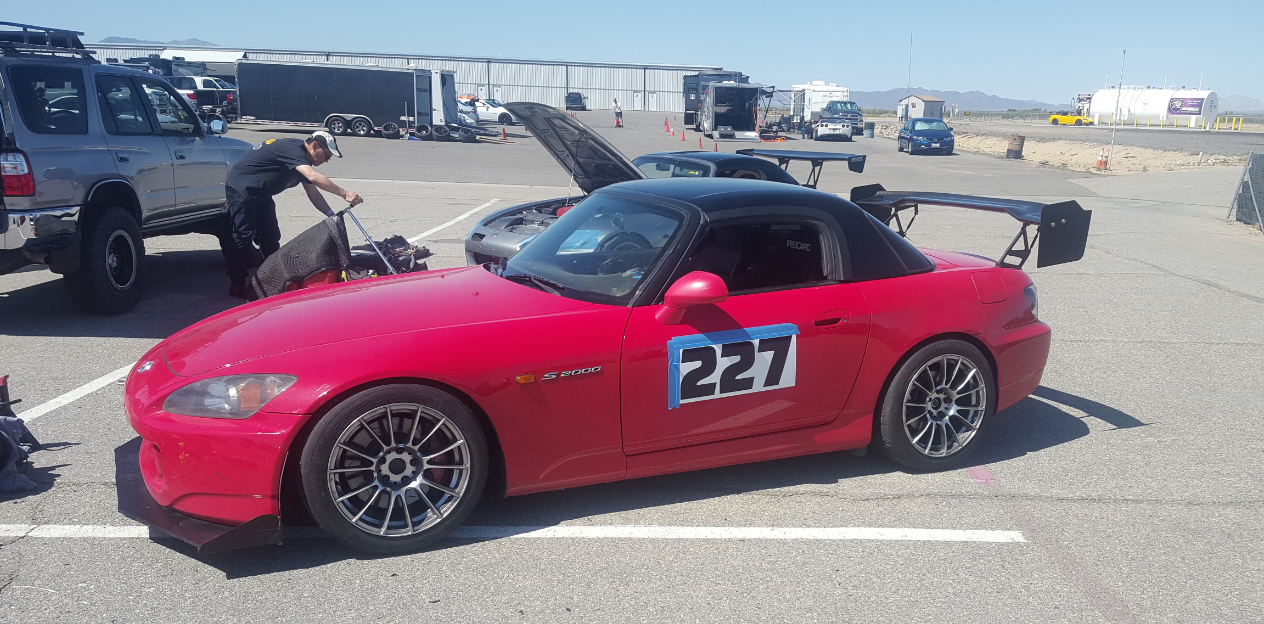

for comparison - old picture of my car with the SA72R wide spec in 17x9.5 +47.
Titan 7 TR10 - $1980 ($495 ea)
SA72R - $1312 ($328 ea)
List prices at Evasive.
