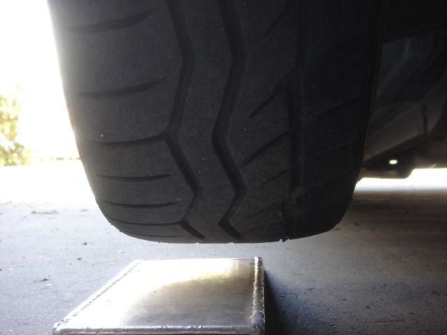

Picture please. My wear FYI is perfectly square. My initial though is toe scrub.

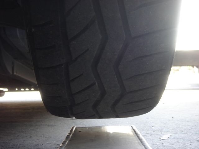

Ok, well i lifted the car to take pictures,.......and the tires look pretty evenly worn now! Nothing like how i described--weird. My description came from when i lifted my car a couple weeks ago. I guess they have worn more evenly since then, so now i'm even more confused as to what would create the pulling. Maybe my alignment settings got out of whack already...i hope not b/c that alignment was expensive!
Didn't get measurements, but the passenger side tire looked to have very slightly more neg camber wear than the driver side, but the over shape of the two seem to be very close. Nothing like how i remember them a couple weeks ago.

Looks like camber related wear rather than toe.

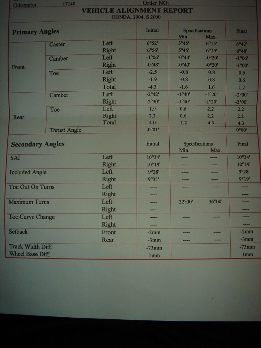

Here's my alignment sheet. It was done a little under 6 months ago, and around 6k mi ago. I'm fairly confident that the shop owner would have said something to me if any of the settings looked off, or weren't good, but what do you guys think? I'm still going to take my car back to get the alignment checked/redone. It's just weird that it would drive fine, perfectly straight, for months, then suddenly go out of whack.

yeah, it looks like the camber was the culprit, your initial readings were about .5 degrees off.
