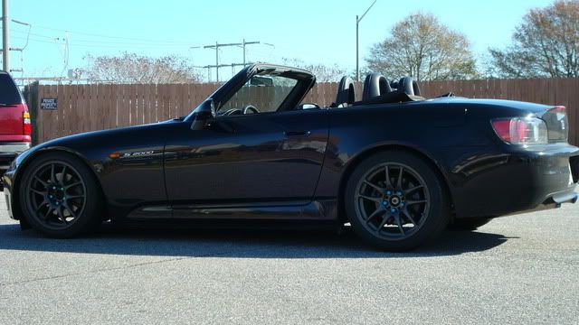

The rear wheel's spokes are shaped differently than the fronts.
1. Are these 18''s?
2. What is the width of the rear wheels?
3. Possibly, do you know the tires sizes as well?
Thanks SO MUCH,
Colton
Old Jan 24, 2008 | 06:02 PM
clzay's Avatar
Joined: Aug 2007
Posts: 138
they are Work Emotions MGM...
Front 17x8 +47
Rear 17x9 +44 "concave"
on stock AP2 tires.

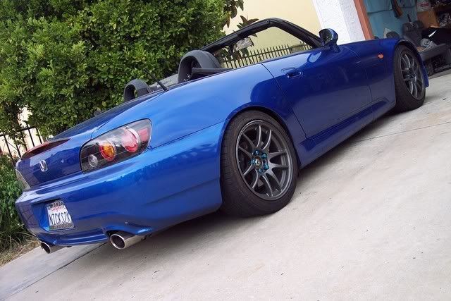

Theres no way those are only 17's. Here is a picture of another set which i had belived to be the same dimensions as the other ones....can someone tell me what these are as well?...
Thanks,
Colton
Old Jan 24, 2008 | 08:08 PM
dalink's Avatar
Joined: Sep 2007
Posts: 939
From: Virginia Beach, Va

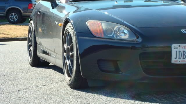

Looks just like my car.
Front 17x8 +47 215
Rear 17x9 +44 245
matte gunmetal

Buddy Club N+'s. You are going to have to roll the rears and be careful in the front. I actually had the front too low a bit ago and messed up my passenger side fender pretty bad, tire too. Everything is fine now, I do however still hit the rolled fenders sometimes. It's on some extreme bumps though so it's not so bad.
I have -3.5* camber on front and back, maxed out
