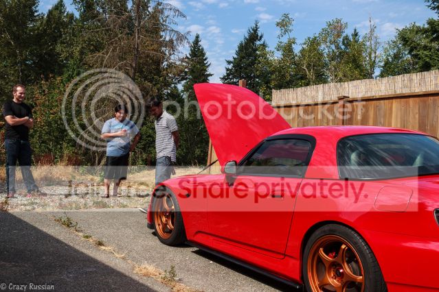

245 will be fine on the 9 inch wide wheel
My rears in this pic were 17x9 with a 245 tire on the rear.
You should roll the fenders before you get the wheels. There is less chance of damage in stock suspension but the wheel still has enough travel that it can grab the fender if compressed right. Trust me I have seen people mess up their fenders because of this and once they are messed up you need a body shop and repaint instead of just a simple fender roll.
