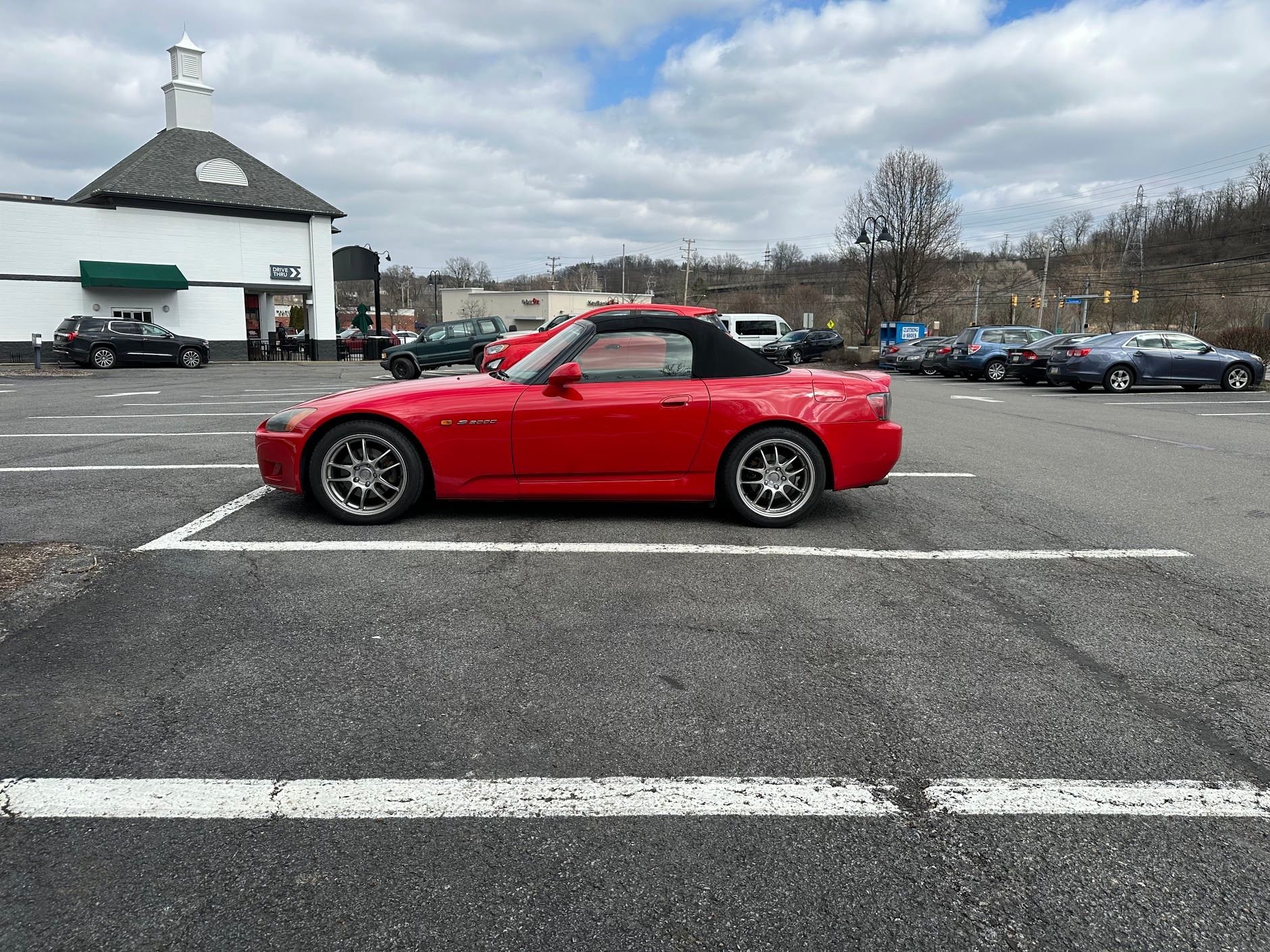

If anyone is looking at this thread for future reference, here's my S2K at stock height! Love these wheels.
