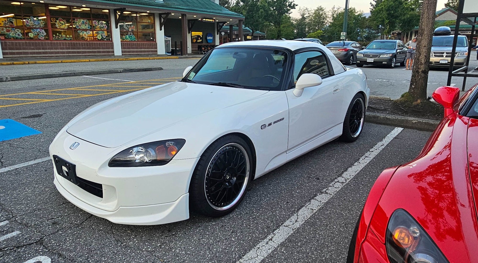

I have the VS-XX on 18x8 +47 on 215/40/18 and 18x9 +64 on 255/35/18 and they don't rub
They look fine from the side, but there's not much lip
do you have any pics? I looked on fitment industries and saw someone running 18x9 +38 and no rubbing but I'm not sure I believe it lol

Sure, not the best pic but here you go
