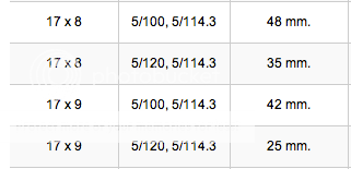

Im just wondering which offset i should get. i want 17x8 in front and 17x9 in the back.
Will these wheels fit? and what ones to go with?
Thanks for your help!

Would i want to go with the highest offset?

17x8 +48 for the front 17x9 +42 for the rear. 225/45/17 front tire 255/40/17 rear tire.
You will need to roll your fenders relocate the rear tab and get an alignment but they will fit pretty easily.

really fenders will have to be rolled?
I concur with manga. Yes these are the best fitment rim/tire options but will need to roll fenders and relocate the rear mount tab. If you don’t care about utilizing the most tire for these width rims then stock size 215/245 would be an option to possibly not have to roll your fenders if your running aggressive enough camber. -2 front -3 rear range. That’s a big MAYBE though, your smart to just do the fender mods anyway.

even the fronts will need to be rolled?

Yes they will. I wouldn't have typed it if I didn't mean it.

what do they come stock in the rear 7.5 ?

Ap2 sizes are 17x7 front and 17x8.5 rear.
