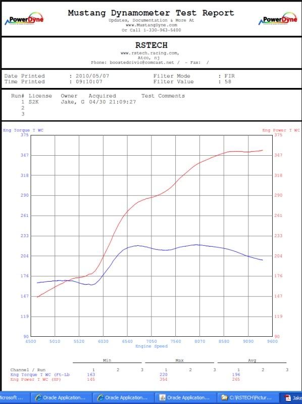

The only dyno graph I saved was the uncorrected graph which is 354hp. Sorry. The corrected numbers are 339.5hp/219tq

Hey there, your front tire is low.... just kidding just kidding. That's amazing to see it pushed this far. Good job. How high do mustang dynos typically read or how does it compare to other dynos.

The mustang dyno tends to read on the lower side when compared to a dyno jet.
Usually around 5-7% lower then a dynojet is what tends to be generally accepted and what I have personally seen as well. . .
