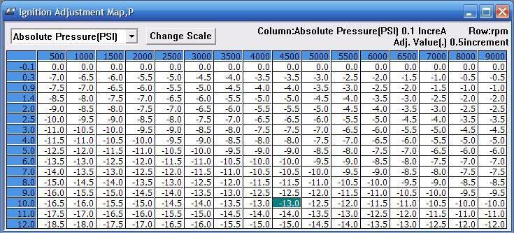

your timing map is way to retarded.and timing map should be something like this
This is an example only to show you how timing should progress RPM VS Load
this map is excessively retarded but this will give you an idea.
I am only going with average of .43 deg of retard per pound of boost.
as RPMs go up Actual timing should move toward more advance (less retard)
As load increases Actual timing should move to more retard (more retard)
------> increases timing
i
i Retard timing
i
V
Neptuner I will send you my timing map after I get off of the dyno tomorrow.
Mark -What do you mean calling my timing retarded?
(Just kidding)
This is the same timing map I got from William 5 months ago and have been running the whole time. The map William is currently running is very similar to mine except about 3 degrees less retard at max boost& rpm. Do you think the timing caused this CEL? Does not seem likely to me.
