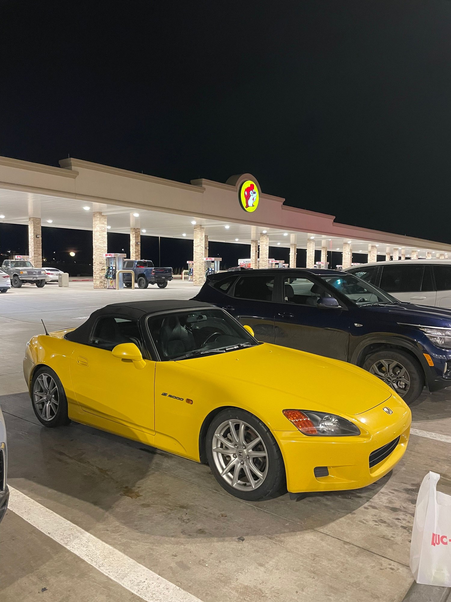

Nice S2k! I like the pic at Buc-ee's

@Elscooby Thanks man, it was my first time ever seeing a Bucees! They don't have any on the west coast.
