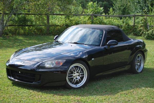

Hello everyone, this is my build diary. Come follow my road to Forced Induction, or maybe not, who knows! Will update mod list as mods are added.
Current Mods:
Engine: ARP Headstuds, Clutchmasters Custom sprung FX500 clutch, Spoon motor and transmission mounts
Suspension: Koni Yellows, Skunk2 springs
Interior: AP1 blue carpet
Exterior: ASM Rear overfenders, JDM clear side markers
Wheels: 17x9 Enkei RPF1's
I bought this car about 3 weeks ago with 150k miles on it, the motor was bad, but we didn't know about the extent of the damage....
