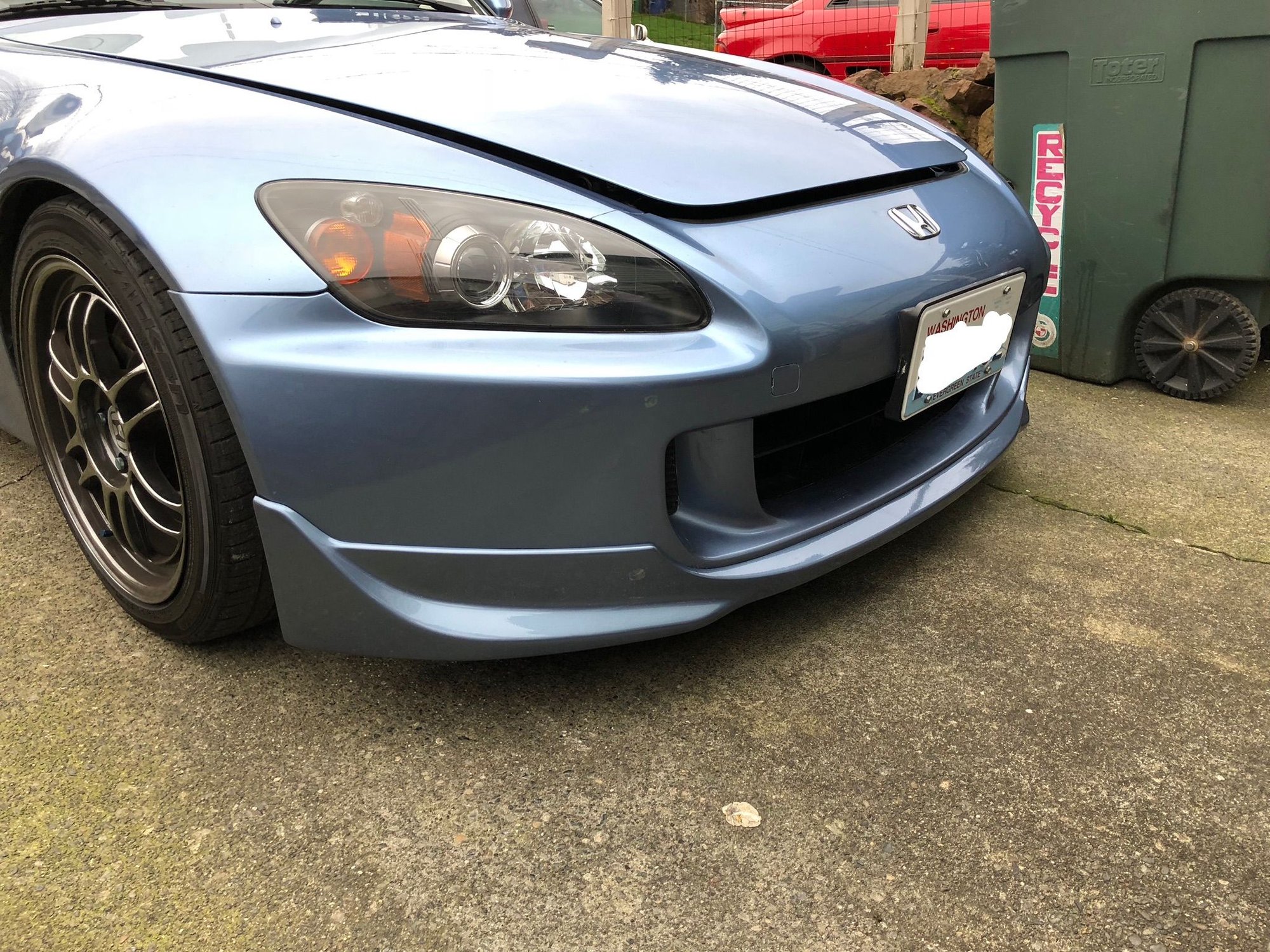

Second : OEM Lip and RPF1s SBC S2K specs.

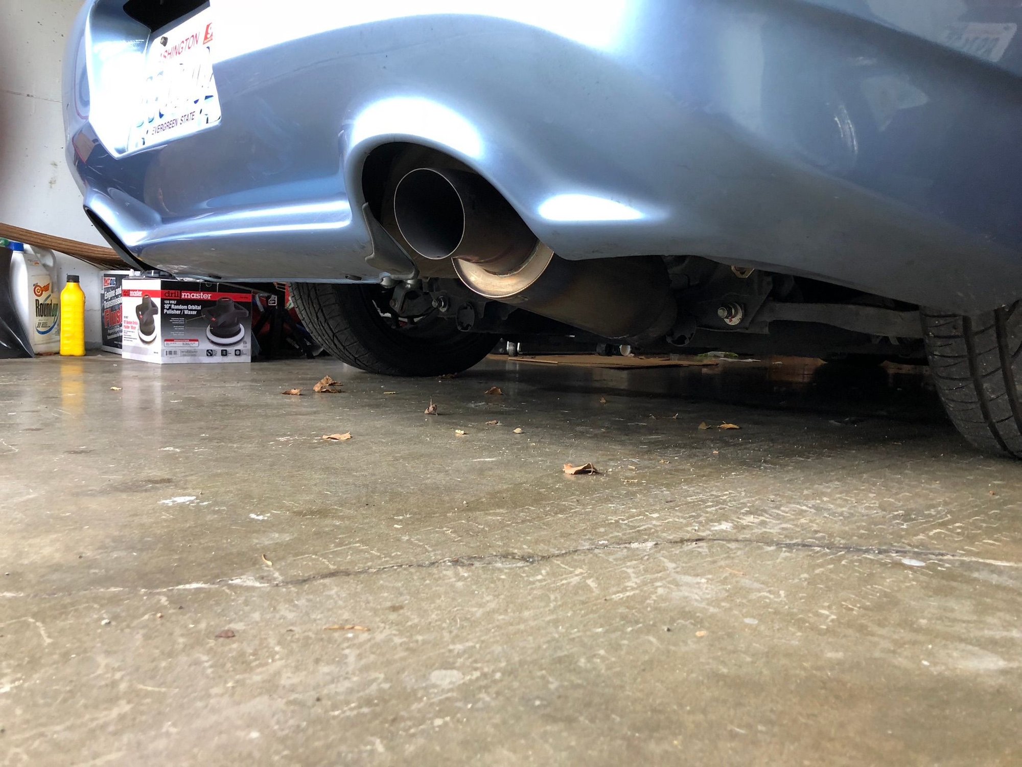

Third : J's 70RS Ti + T1R Resonated Test Pipe

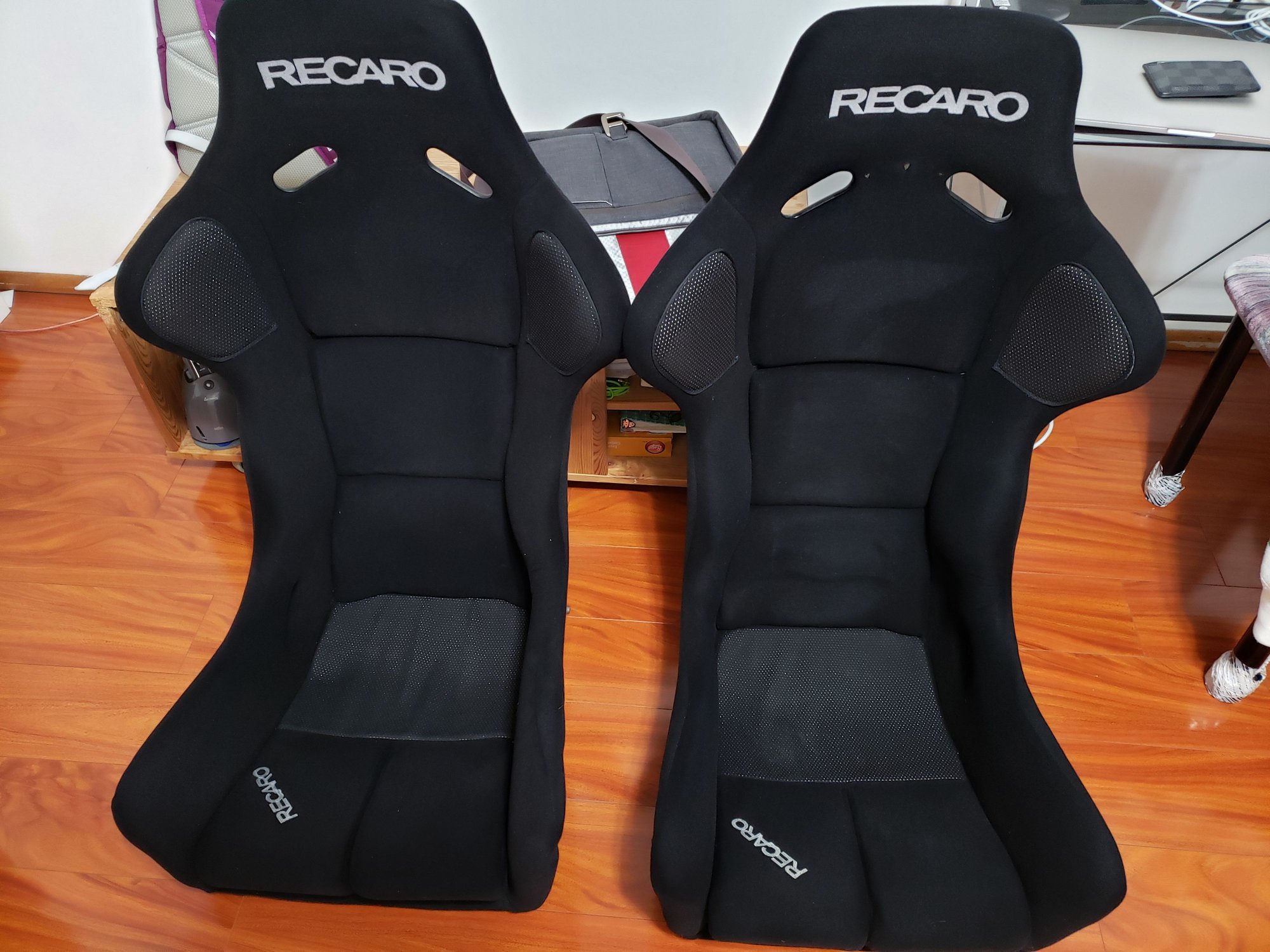

What's a track car without bucket seats? LoL. Picked up a pair of Recaro SPA (baller status) from another S2ki member with rails. After woolite and let it dry over night, these seats look LEGIT! They are extremely light and is in near perfect condition!
Before the install, had to remove my stock seat (which i sold), I figure I wont need them? I saw a few on eBay in Suzuka blue as well, so it wont be hard to find if I ever wanted to go back to stock.

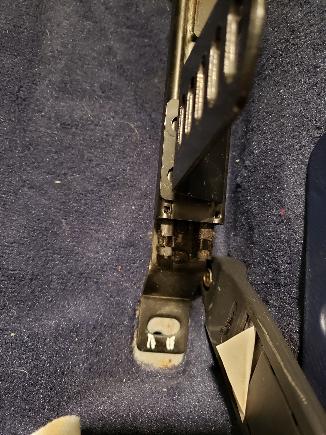

The driver rails fit like a glove! They are the Nagisa Auto Super Low Down Seat Rail D-Lock. But the passenger came with Buddy Club and ohh how they suck. They didn't even line up, so I had cut off a little piece of the rail as marked below.

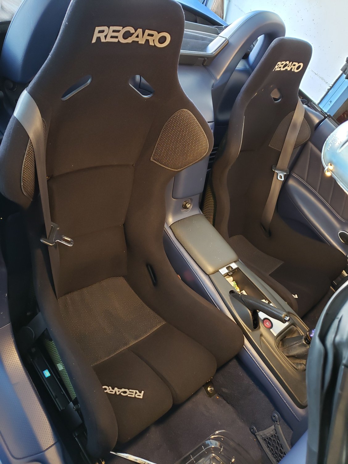

FINALLY AFTER 8 HRS!!! Most of it was taking it out, adjusting, putting it back in... then out .. then in, then readjust. In the end Recaro install was a PITA. (Ohh the Shift Knob is an ARC, it feels great. But its lighter than stock leather knob)
Now for my review after sitting in it. LoL, they look nice, they feel nice and they fit really nice. But if you are short (5'5), I wont recommend them. They sit really really low. With stock seats, I was able to see pass the hood. Now these, i can't. Also they are harder to get in and out, really really hard. You have to put your right hand on the center console and on the door still and push yourself up and out.
Also with these seats, the center console doesn't open if both seats are slide all the way back. One seat has to move forward for it to open, even then you have to use a little force to fully open it. Lastly, more complains about the buddy club rails. Since the passenger side has the transmission hump, the rail adjuster thingy would not fit. So you cannot adjust the rail when the seat is in the car. The only way is adjust it before then put it in. What is worse, when they are in with the seat fully back, the back two bolt is blocked and there no way to get the in there. I was able to only get 3 (i know unsafe), bolt fasten. I need to get new passenger rails later down the line.
