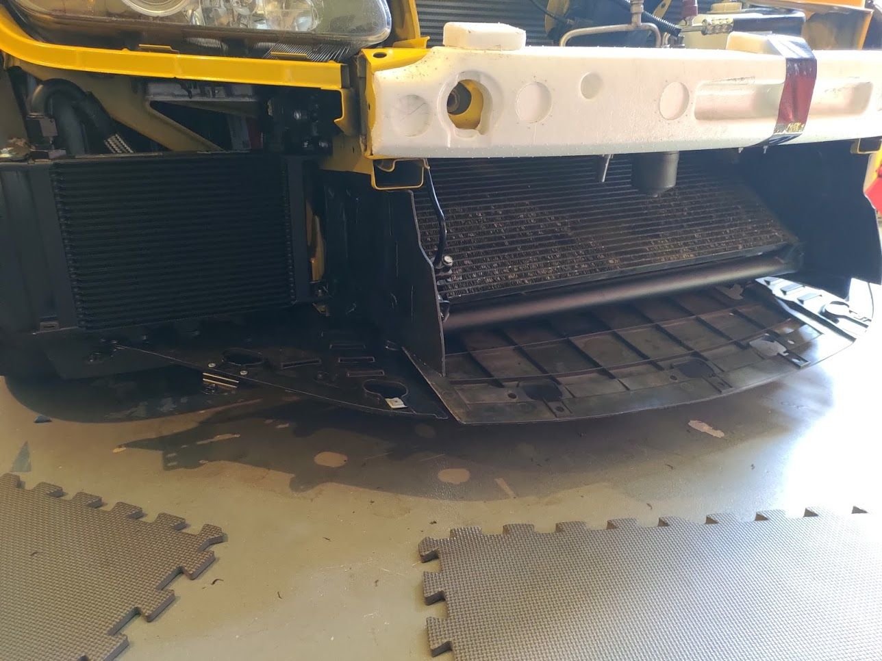

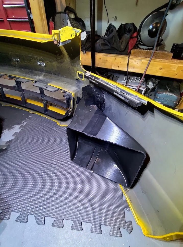

Got some more things done. Finally put the under plastics back on. You have to cut the front lower plastic as the v-mount bracket gets in the way. It goes back on fine just needs to be split in 3 pieces.

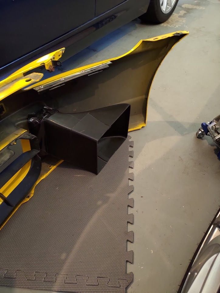

Test fit the oil cooler duct. I just need to trim the back edge a bit and cut a vent in the fender liner. Got this from Tommy at Baero. It's 3 pieces 3d printed and fused together.

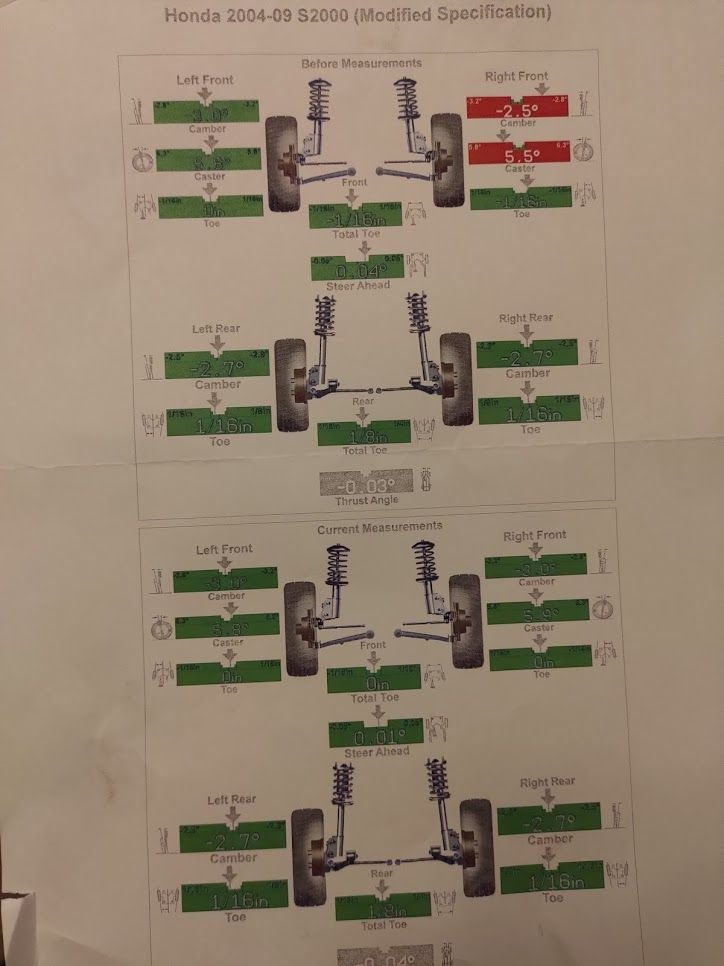

Another thing was got my alignment and the AC charged. Fortunately AC charged and blows cold, don't seem to be any leaks.

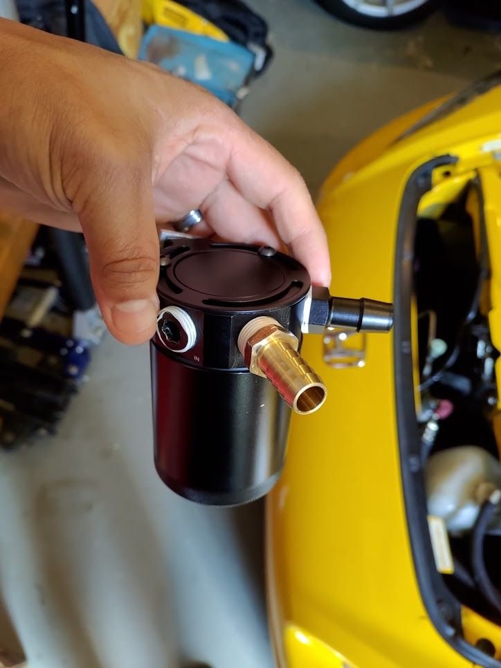

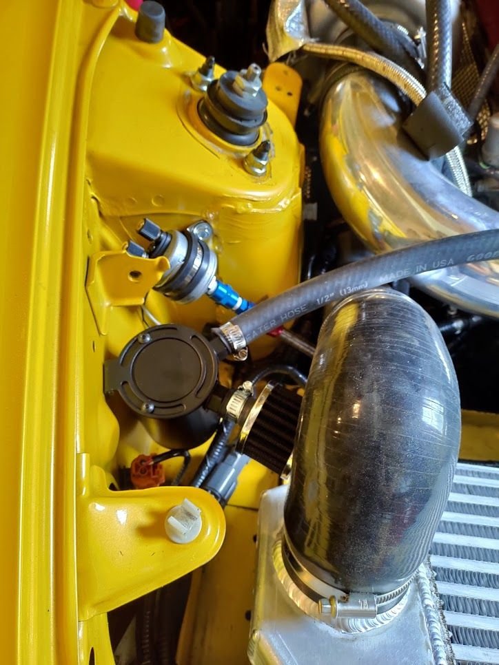

Got the new oil pressure sensor in and mounted properly. Also got a couple catch cans and moved the horn on the passenger side to the drivers side. The catch cans are cheap ones off of amazon. They look like Mishimoto knockoffs. For the cost of ~$20 each you can't go wrong imo.

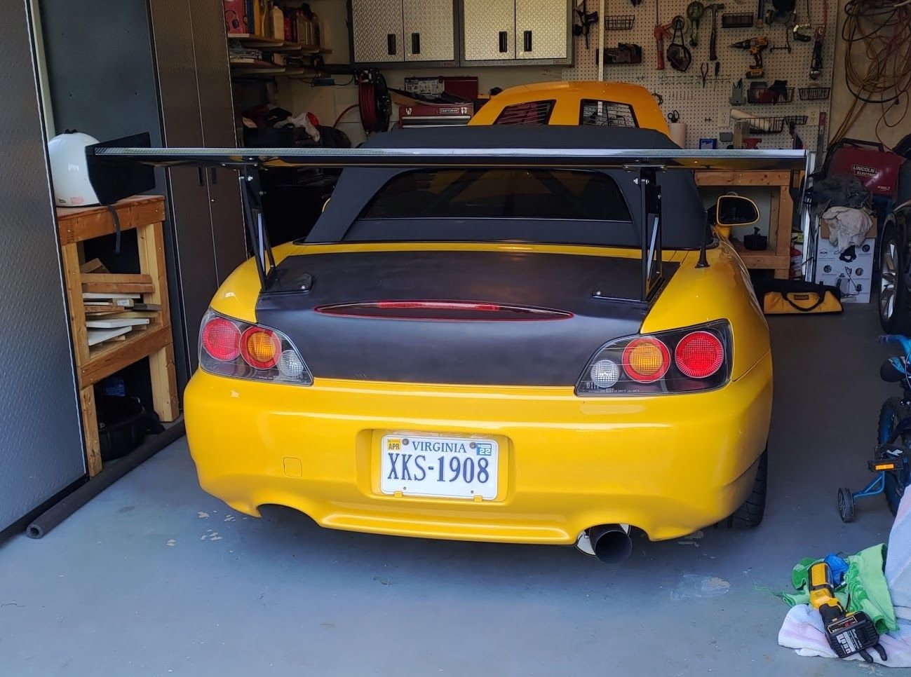

Swapped the trunk lid with the wing. Still need to adjust it so it's at 0 degrees AOA. Here's how the car sits.

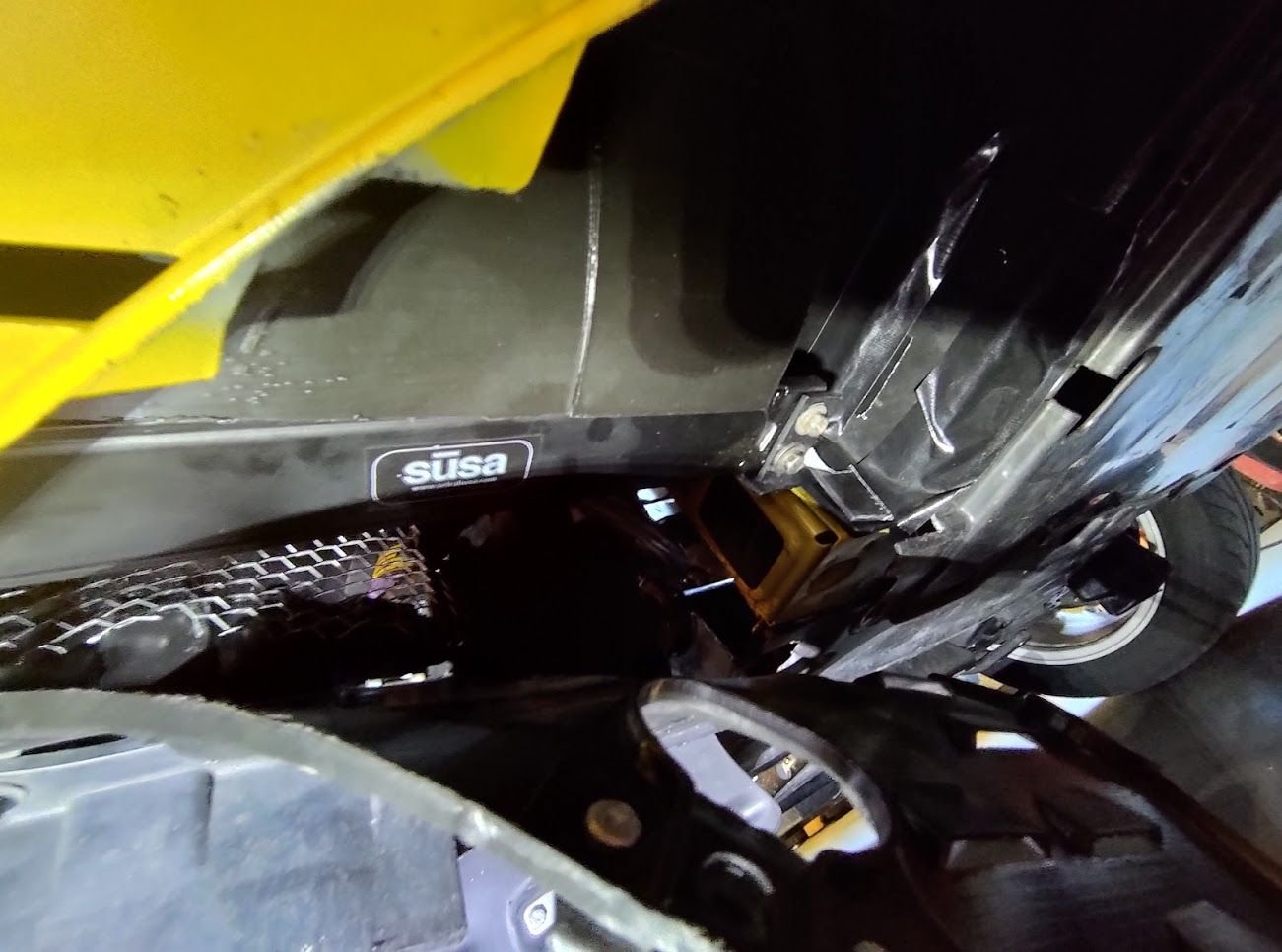

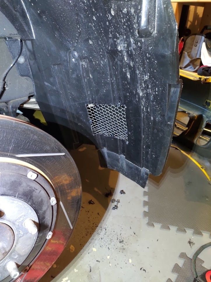

So backing up a bit. Friday I installed the oil cooler duct. I cut a roughly 4.5"x5" hole in the fender liner and secured some mesh with zipties. I didn't want to cut it too big that way air would try to be forced through the cooler and not try to go around it, even though the duct is almost touching the setrab cooler.
Here's a shot of the Baero duct from underneath with the fender liner pulled down and the bumper on. It's trimmed to length and I used a piece of duct tape to "seal" the bottom edge.
Cool thing about the duct is it's so light I just installed it with duct tape. I was planning on siliconing it on but it was quite sturdy with enough duct tape.
Here's a shot with the car all ready to go to the track. I set the wing to roughly 0 AOA with a level.

Another small thing is the catch can that is fed from the stock pcv location filled up with oil by the end of the 3rd session on Saturday. I did the rainh8r mod but I guess the increased crankcase pressure is pushing it out before it has a chance to drain. The front port was collecting some oil in the catch can but much less. The catch cans I have are pretty small so it's not a big deal. It's fairly easy to unscrew and dump them. Good thing is after changing the orings on the dipstick it doesn't pop anymore due to crankcase pressure.

Oh ya, another important tidbit of info. The wing with the taller stands means you can see out your rear window completely unobstructed.
