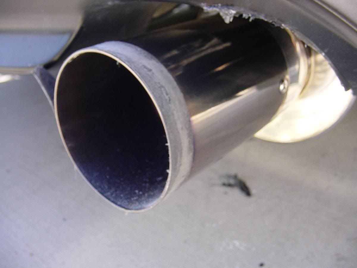

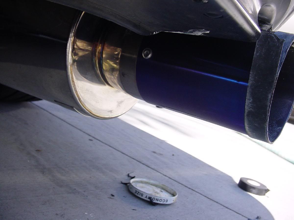

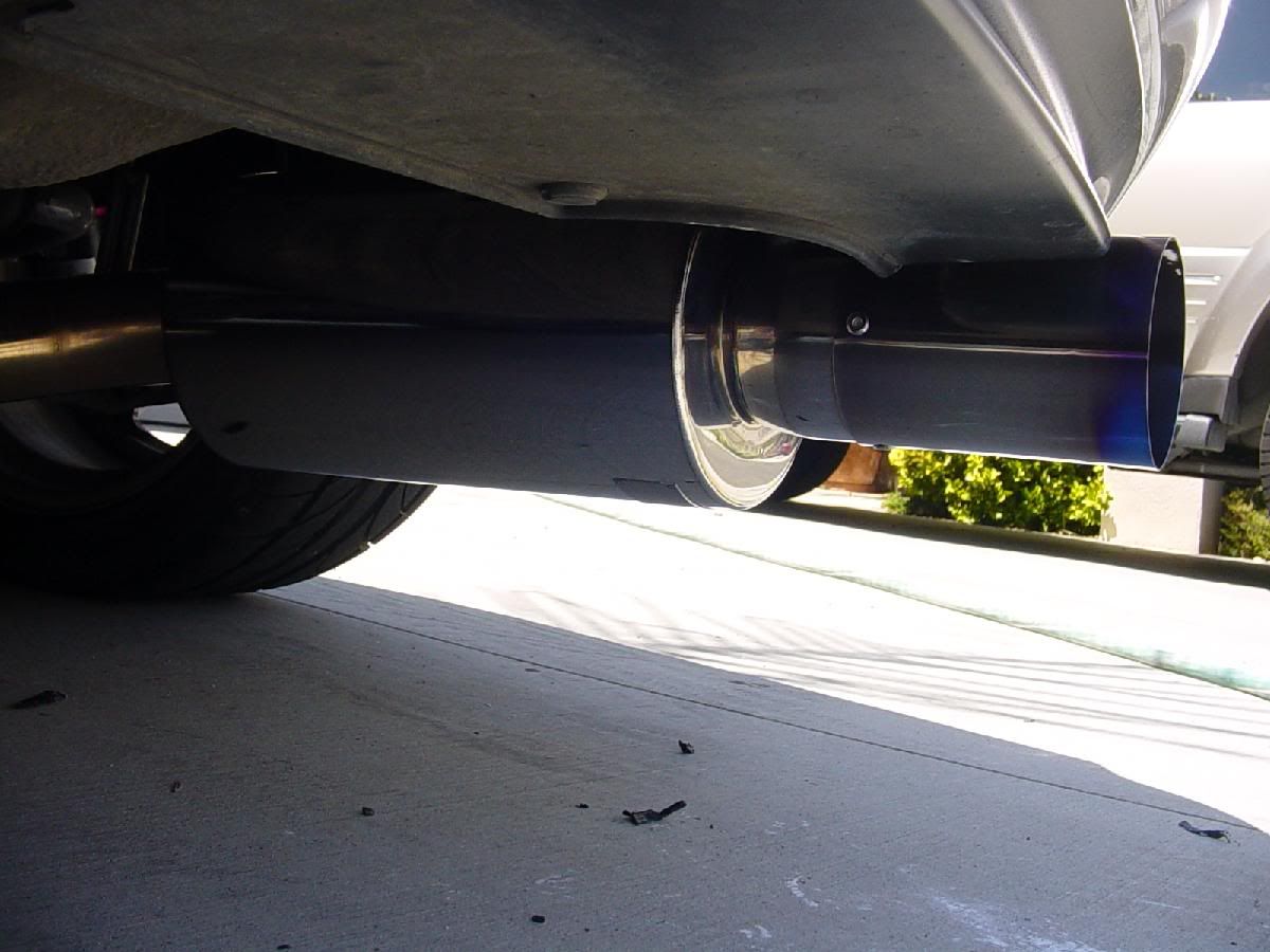

After a hour drive home I inspected my exhaust:
(Excuse the 1st few pictures, they were with my camera)
After wiping stuff off with a towel...
Damn, what a buzzkill. The exhaust seemed to have plenty of clearance between the tip and the bumper. WTH happened?! After inspecting the exhaust, I noticed there were only two hangers on the right side. The exhaust can easily swing to the right with a sharp turn or jolt. When swinging to the right, the exhaust touches the rear valence. (I fixed the problem by securing the hangers).

After polishing the black off a bit, I noticed the blue/purple titanium color was faded. I didn't like the entire blue tip anyways and I preferred something like this: (the original T1R style tip)
30 minutes later:
Other side:
2 hours later:
I was pleased with the results. I'm sure I could do better with more work, but it was pretty hot so I decided to call it a day. I will have to sand down and work on the bumper another day. The tip should change color a bit, since it is titanium. Hopefully the "Ti Burned" look will look more gradual then. If not, I'll have to work on it.

I didn't take a picture, but after cleaning off the melted rubber residue, it was not blue underneath and very splotchy. I could not live with that.
