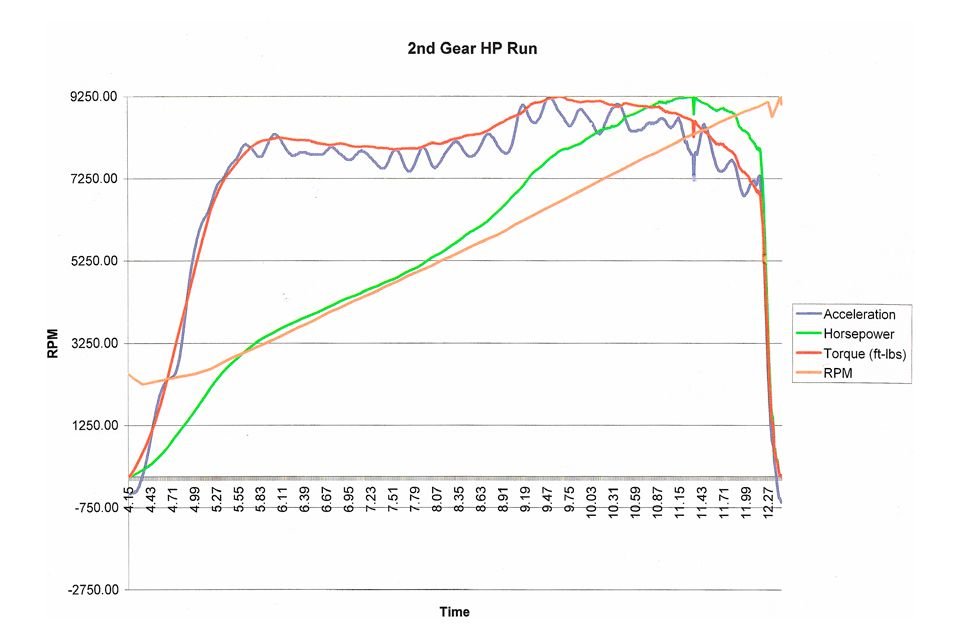

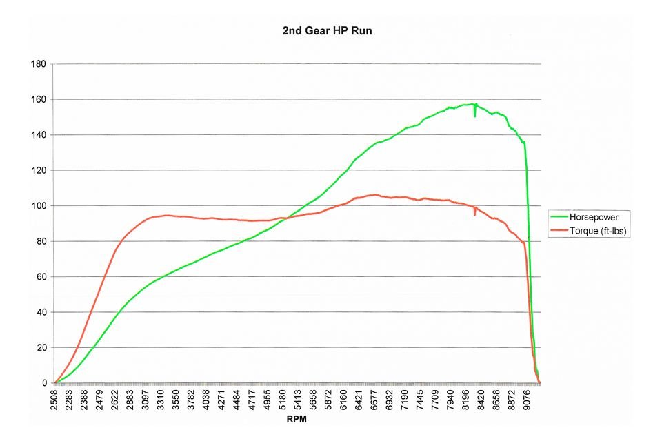

I know this is an old topic but I believe I have very good pictures that will make this VERY clear to everyone, so I'm going to reply and bump this one.
When I got my 2003 s2000 I also purchased a GtechProCompetition.
I always wanted something that could do what the gtech does because I knew with it I could easily clear up the HP vs. TQ questions I had as well as log very useful data for me.
Here is a Gtech Dyno run in second gear when the car only had a few thousand miles.
Now note that you are driving the car when you make a dyno with the gtech so it accounts for everything. This is true RWHP for my car in second gear. At 64 MPH we are using about 11HP just for drag. If you figure ~30HP is lost to the transmission than this would be about a 200HP run, a bit low for a 240HP car. I suspect I had the weight set low.
Note the shape of the torque curve.
The gtech records accelerations very accurately over time.
So I can also graph the acceleration curve.
Which curve do you think will look like the acceleration? HP or TQ?
Here it is! Note that it is normalized I've scaled the graphs to match their peaks to the top. We don't care about the amount of acceleration or the amount of any of these graphs. For our purposes all we want to look at is the shapes of the curves.
The torque curve is IDENTICAL to the acceleration curve. The HP curve is a completely different shape!!!
Just as chenpin said:
When you get pushed back in your seat it's from a force and torque is going to relate to that feeling of acceleration 1 to 1!
I think chenpin's post was the most useful. He articulated everything very clearly and covered pretty much all bases.
I wish I had read his post before writing the long post I did. But after reading enough of the posts I figure the only thing to add were the images really so this has been cut down to size.
Thanks,
-mikey
