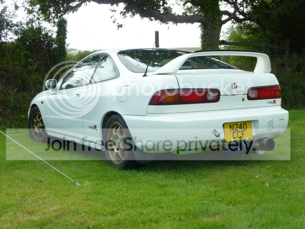

Last year when i had a jdm dc2 i had your car as a wallpaper on my phone how are you finding the s2000 compared to the dc2? when i changed i preferred the dc2 as the engine and suspension felt more responsive and exciting but the s has the looks plus its turbo'd now so it has the power.
Old Jul 9, 2012 | 03:47 AM
  #40
nick300zx's Avatar
Joined: Oct 2011
Posts: 1,008
From: Cromer Norfolk
It was the one where you were looking down on it (possibly out of a window?) with the bonnet open.
pic of mine.
