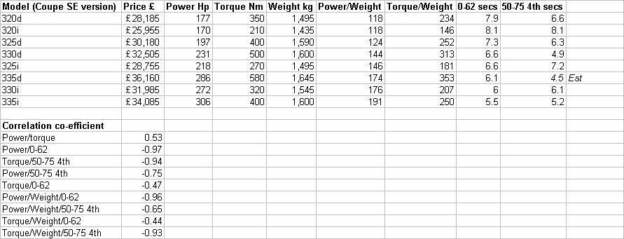

OK, updated with the Power to weight and torque to weight figures included.
A couple of observations - as expected power to weight is highly correlated to the 0-62 time (-0.96) and torque to weight is highly correlated to the 50-75 time (-0.93)
However, it's interesting to note that the 325d and the 335i have the same torque to weight ratio but the 335i is much faster in both variables than the 325d.
Also, the 330i has a much lower torque to weight ratio than the 320d, but is again faster in both variables.
It also shows how slow a 320i BMW is. Anyone buying a 318 must be out of their mind, 0-62 in 9.1 and 50-75 in 9.4. All starting at the bargain price of

I think that's fair comment.
