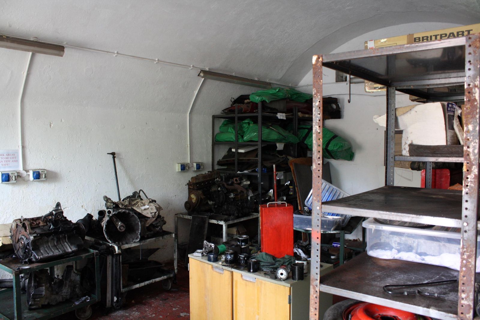

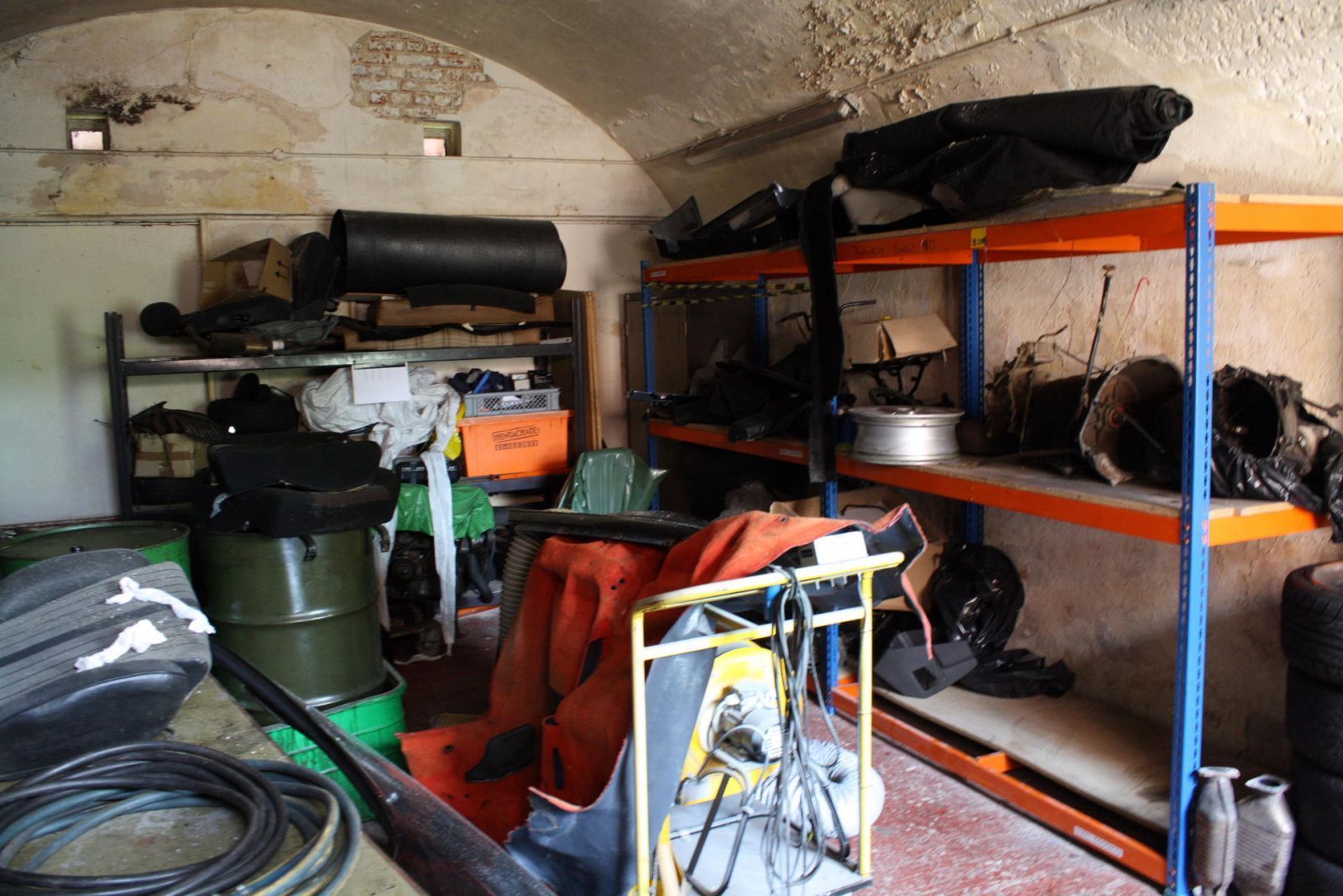

The car club is situated in the casements of a palmerston fort, in the grounds of HMS Sultan. Facilities include storage for project bits:

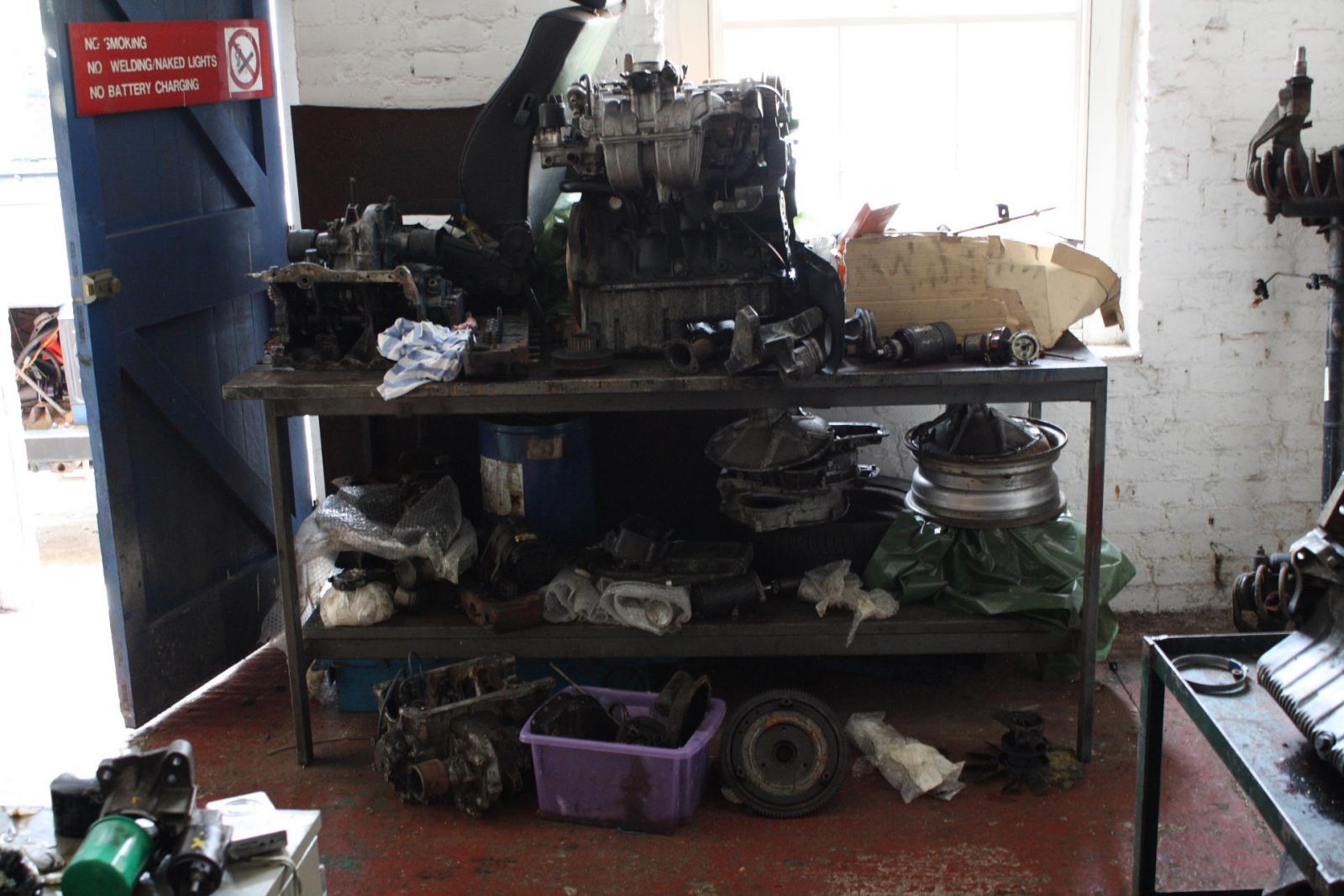

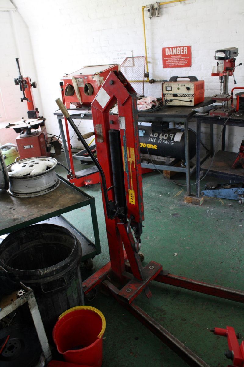

A well equipped workshop area:
Two four post ramps and a 2 poster:

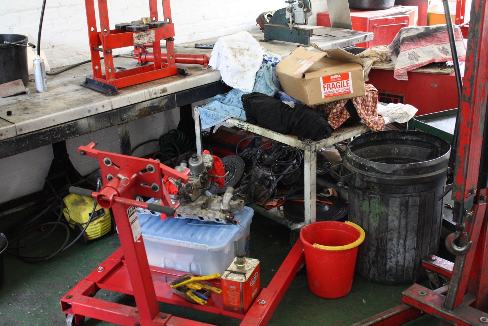

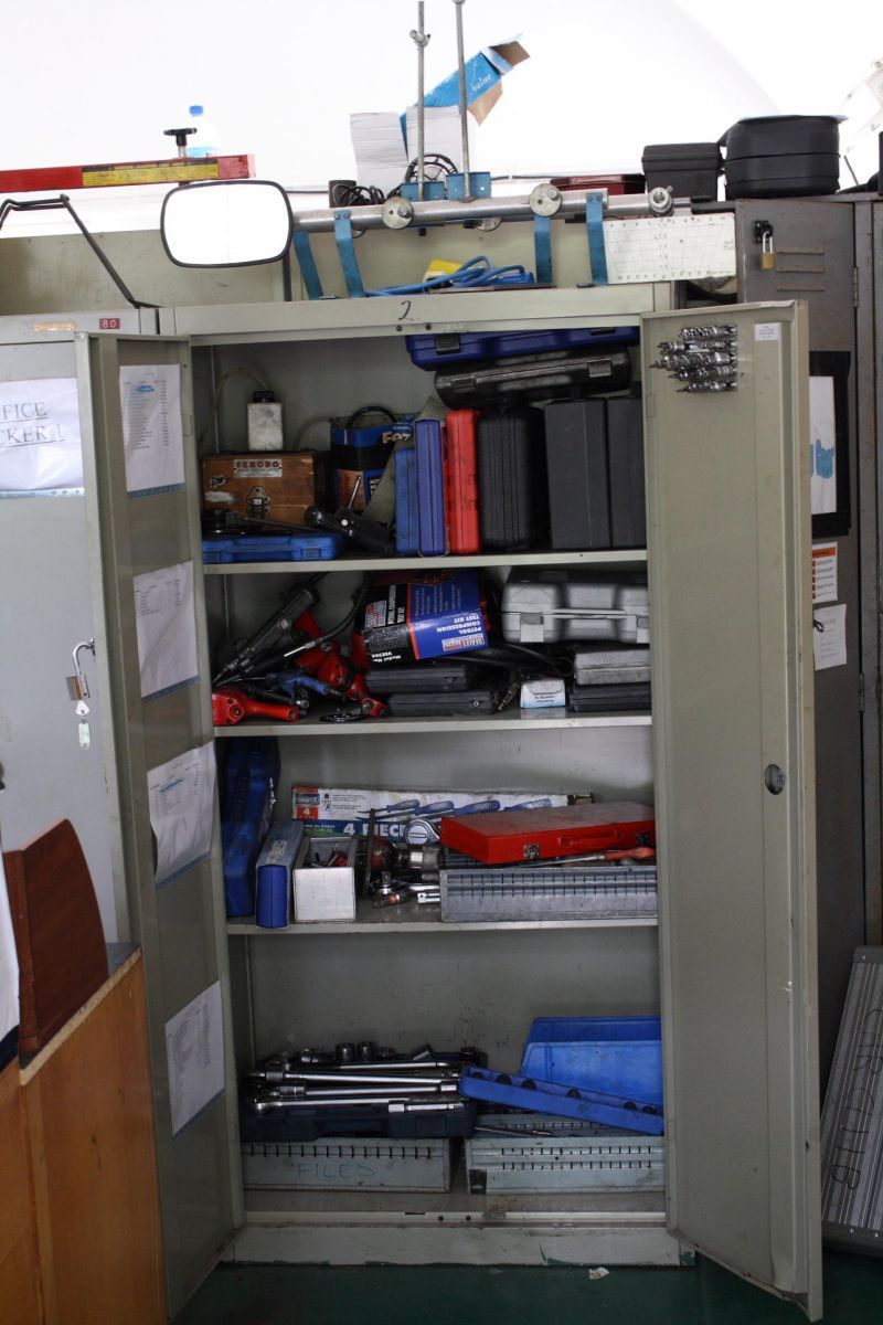

and more tools than you can shake a stick at:
This is 1 of 3 cabinets, plus full tool sets in the bays.

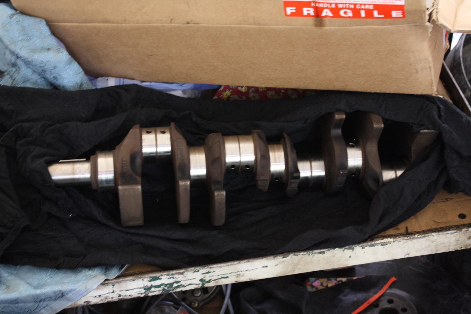

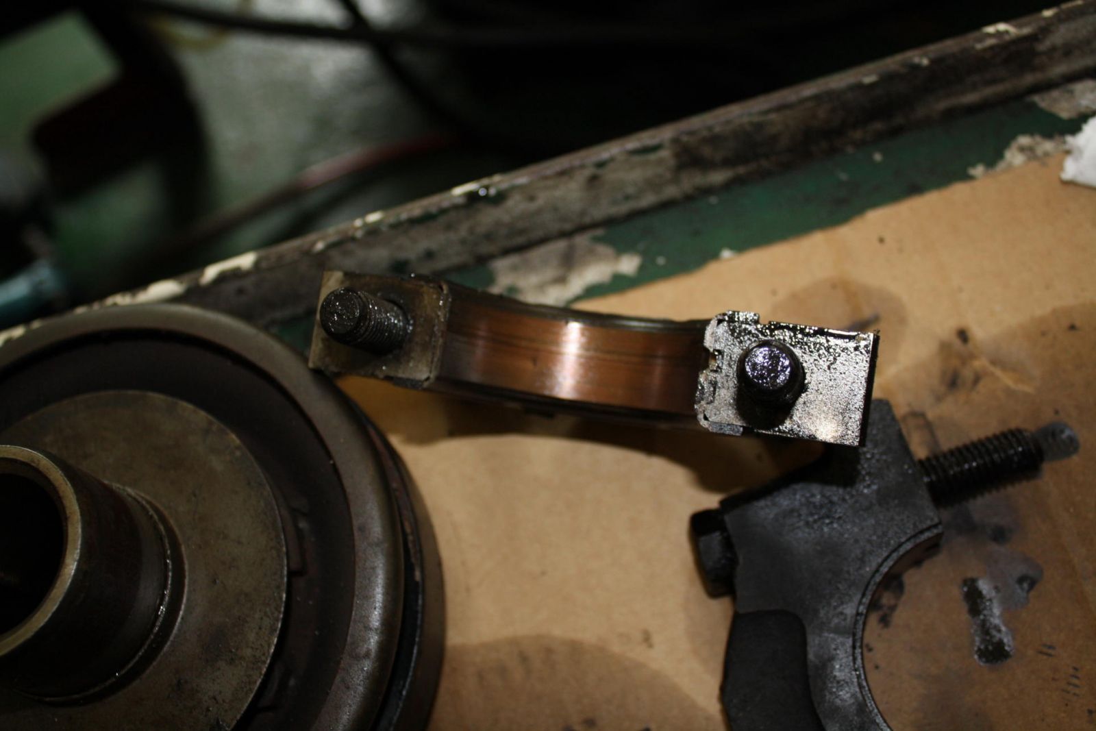

The crank, post a good clean-up. Again, some very minor superficial marks, but OK. The dark lines are the oil varnish left from between the two big ends that run on each journal:

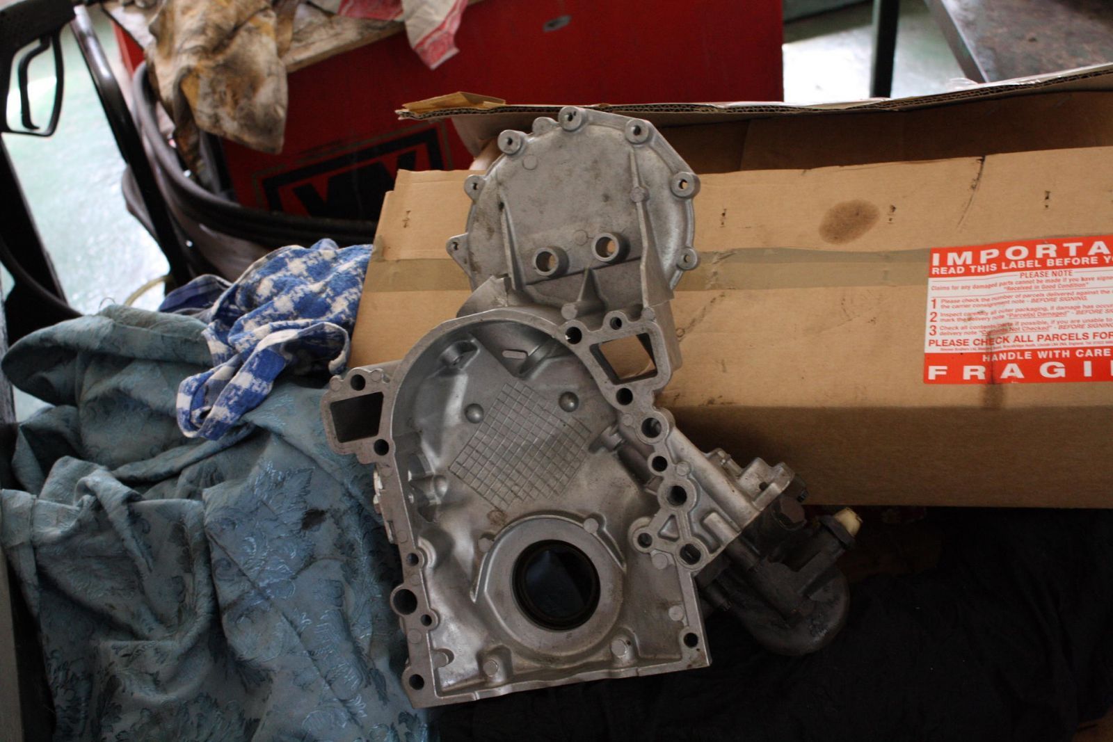

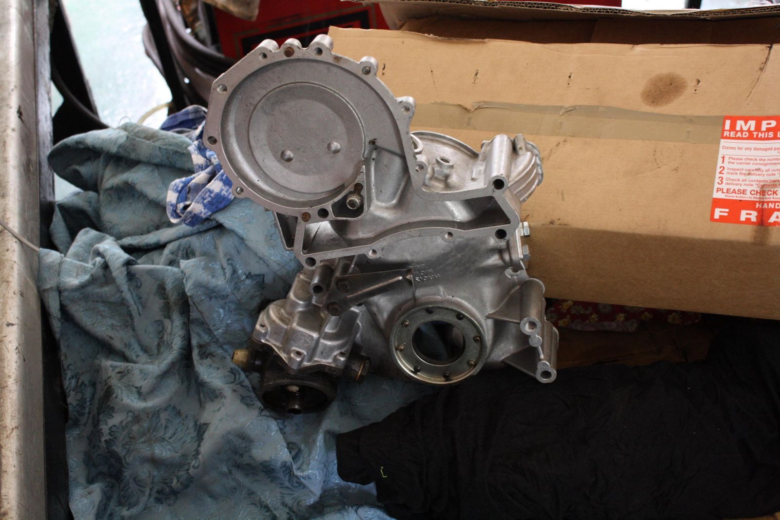

Here's a bargain: New/old front timing cover that I acquired for two evenings' labour on a mate's BMW brakes:
Regretably, it's from a very early range rover (I think) as it has the shorter oil pump gear case and a hole for a mechanical lift pump. After some quick thinking, a gear pump upgrade kit was purchased, along with a new set of the longer (higher flow) pump gears. The fuel pump hole was the work of but 20 mins with the scrap aluminium drawer, hacksaw, file and drill... then another 5 re-drilling and threading the casing to accept my metric bolts and sealing it all up with a generous dose of silly **** sealant! All in all, a bargain at
