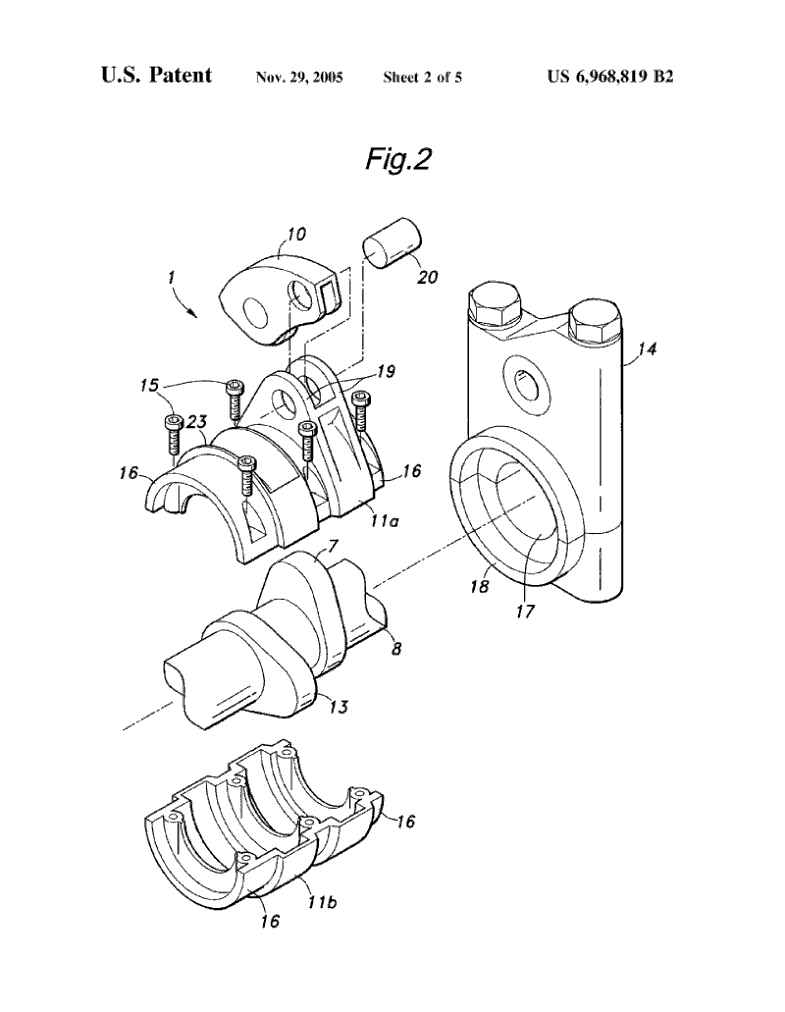

I had a weird idea about this once.
If you make the lift point on the cam shaft like a very large drill bit and the push it forwards or backwards with some hydraulic presure, you would have a variable system on a single cam
Difficult to explain see picture in my head....

It's a point that's subject to huge load & wear problems, due to the massive springs required to prevent valve bounce. What Honda do is use a moveable lever to vary the 'size' of the cam lobe;

Ok imagine the wee green bits (the valve lifters) were knurled like this
Pushing the camshaft forwards and backwards would vary the lift point within a range but very smoothly.
FIAT were looking into that; each cam was big at one end and smaller at the other.
You slid the camshaft along, to reach the higher lift range.
The wear killed it.
