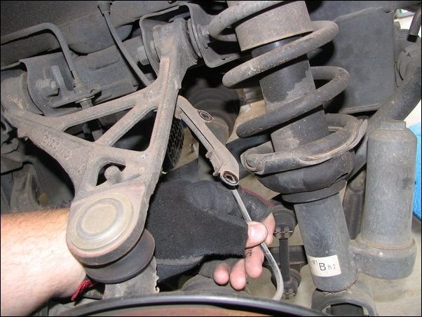

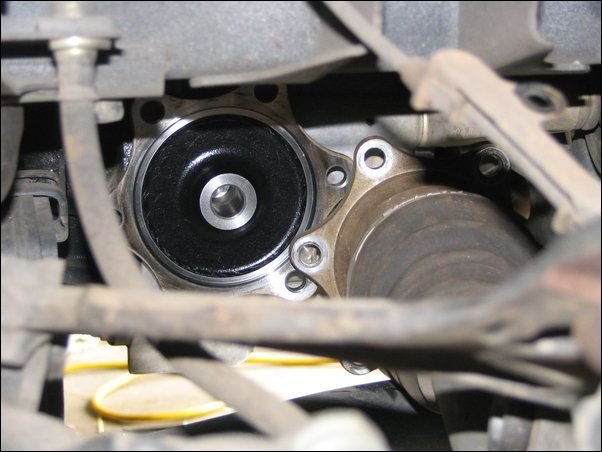

With the car up on stands and the wheels remove, unbolt the ABS sensor bracket from the upper control arm:

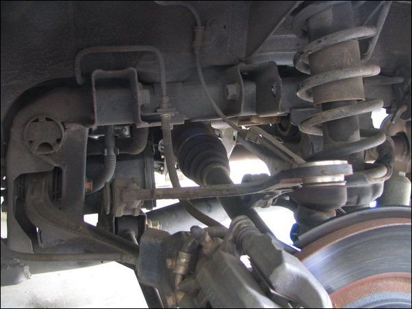

Unbolt the upper control arm from the subframe and let the lower control arm droop a bit. Support it with a jackstand or something to give the brake line some slack.
Remove the 6 bolts from the inner CV joint and separate it from the diff. Push the axel to the back of the diff and set it on the subframe.

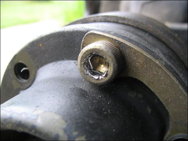

Remove the 6 allen bolts that connect the driveshaft to the diff. This is where I ran into problems. I stripped 2 of the allen sockets.

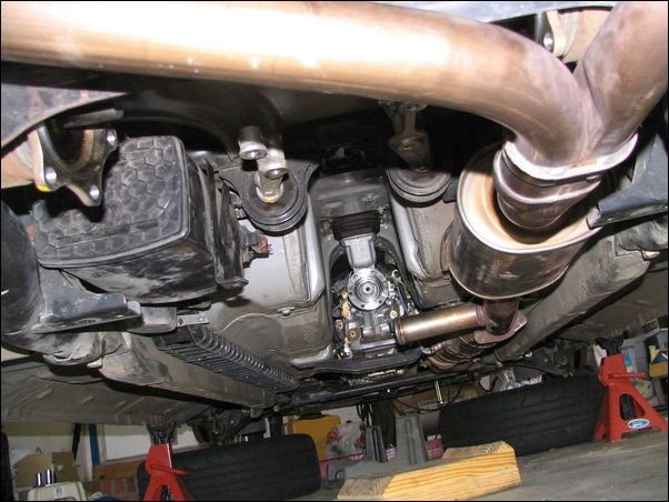

Now I was stuck -- how am I going to get these screws out, while I'm laying on my back under the car... I know, I'll unbolt the driveshaft from the tranny, pull the whole thing out, go to dinner and deal with it later.

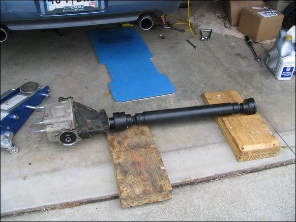

Diff and driveshaft are OUT!!!
Now, after dinner, I tried to get those stripped bolts out. I tried a hammer, bigger allen keys, torx bits, damaged screw removers, wreches, bigger hammers, but this is all I got:

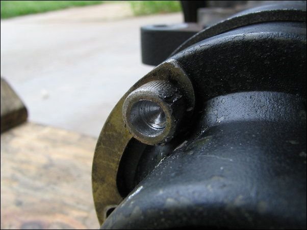

Then, I tried drilling:

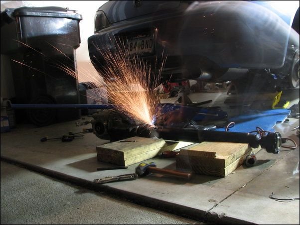

I decided I needed reinforcements, so I ran to wal-mart and picked up one of these babies:
Take that, you little bastard!
and that:
oh, take that too:
mmmuhahaha!!! I win!!!
The diff and driveshaft are now parted!
