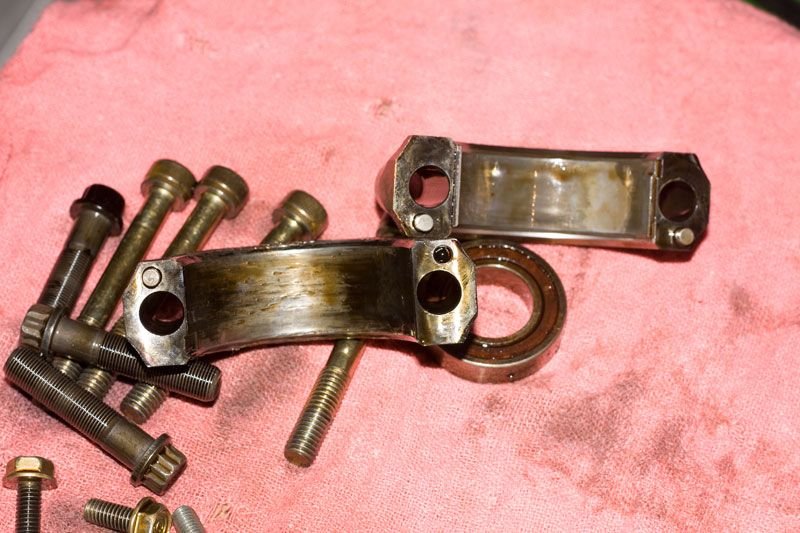

I'd bet the crankshaft and/or the the big end of the #4 rod will be damaged. Everything else will likely be fine, except for the head that was already suspect. If the head is salvageable, I think you have reasonable spare that could be rebuilt if necessary.

Here's a clue to the state of the rod and crank journals:
My questions is, do you think the crank is repairable? I've put oversize bearings in a rebuild before to account for wear but I've never had to deal with a damaged crankshaft.

Originally Posted by Ron,Sep 27 2008, 08:03 AM
Yeah, those were my thoughts too.
Ron, I had a similar problem with my TR3 many years ago.
If the crank is not scored too badly, you could do what I did and have it turned maybe .0010 oversized and match with bearings that would "float" That way, you would get much quicker throttle response. Only problem I had was a loss of oil pressure.
