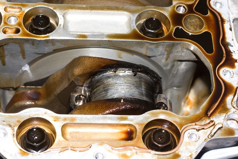

I finally got Sheila's old engine up on a stand yesterday. (Thanks, Bryan!)
When I rolled the engine over to take off the oil pan I heard a lot of metal banging around inside. That can't be good. Then, when I pulled the pan off bolts and bearing caps fell all over the floor. WTF?!
Turns out, the shop had unbolted the bearing caps of #1 and #4 and then just dumped bolts and caps in the pan before putting it back on.
We didn't throw a rod but we did spin the bearing on #4. (Exactly what Bryan said he thought.) The block is fine but I don't know the condition of the #4 crank journal since it's still covered by the spun bearing. I'll have to push the piston down a bit and free it up to see.
Here's a picture of the offending journal, covered by its spun bearing:
Next I'll start pulling off the top end to get a look at how Crown Honda's disastrous valve job has fared. The car ran rich as if at least one valve was leaking hydrocarbons after that and never again regained full power. Since Crown doesn't stand behind its work this will be the first chance to really see what's going on.

Originally Posted by Ron,Sep 26 2008, 07:17 AM
OUCH!!!!!

That does look nasty! Glad progress is being made.
