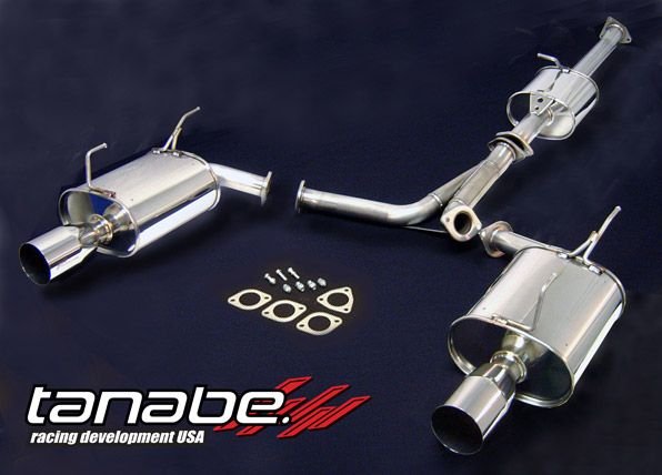

I recently bought a Tanabe SMH from a guy on the board. He did not include the exhaust gasket that fits between the stock cat and the aftermarket midpipe. It is highly doubtful someone happens to have one laying around, but does anyone have an idea where I can pick one up?
Unfortunately I cannot reuse the stock donut gasket for the exhaust, and I do not want to run into leaking in the future.

i need the three bolt gasket. I do not think you can get that at a dealer...correct me if im wrong.

from what Ive read the donut doesnt work. I guess Ill measure the gasket size and bolt spacing and see if I can find one. thanks for you help.

Just take the pipe into any autoparts store and keep trying gaskets until you find one that fits. I had to do that with a Mugen exhaust that I had on my Prelude.
If all else fails, they sell blank gasket material too and you can cut your own.

or you can buy a testpipe. It should come with the correct gasket (my megan did). You get the gasket you need and some added performance
The autoparts store should have them as said above or you could probably go to a midas/meineke. They should have some as well.
