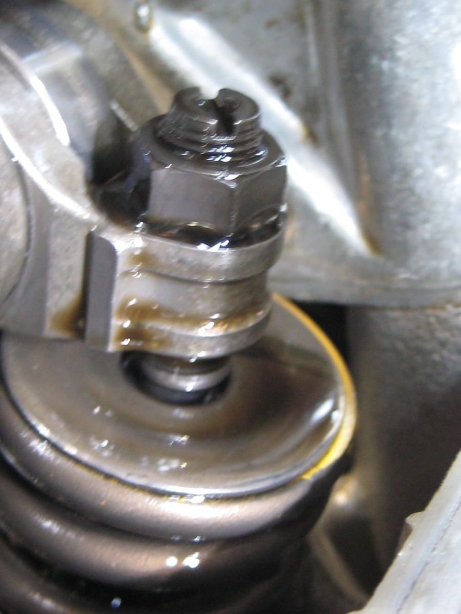

Well, I didn't even adjust one valve. Got everything opened up and a couple of the intake valve retainers looked cracked. Sent the PM to Billman. If he can't get me in soon, does anyone know anyone in the area that they would trust to swap the retainers?

What years have the retainer problems? You are making me nervous.

from Bill's posts, it's any AP1. Honda used thicker retainers in the AP2.

Well now I'm just nervous I have a ticking time bomb on my hands. I've never over-revd the car. At least never that I could remember, and I'd think that'd be something I'd remember. I PM'd Bill about setting up a time for me to make the trek up to him. I also see in his sig that he has a link to a thread, anyone know if I have to post up a request in that thread as well? I don't want to step out of line and piss the man off
In any case, here are a couple pics of one of the suspect retainers...
