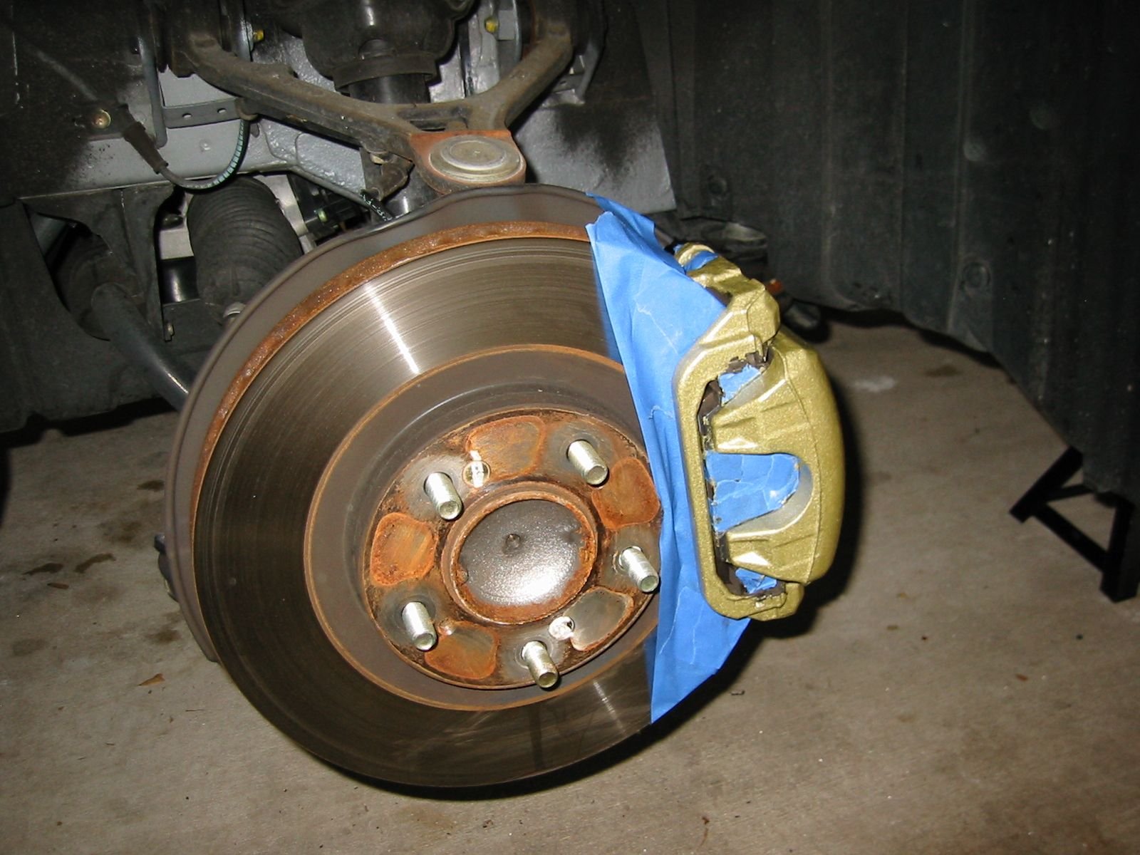

I finally had a free weekend to get started on this project. I've wanted to do this for a while, but with a Suzuka car I wasn't sure what color to go with. What goes with light blue? Tough call. I wanted a Brembo-like gold color, but I was afraid the available kits would be more of a "blingy" gold color. So just in case, I ordered a gold and a silver. If I didn't like the gold, I'd put on the silver, or even mix the two colors together to get something in the middle.
Anyway, I got the already well-known G2 kits. They are $38, I got mine from decalgirl.com, and I got some blue S2000 caliper decals as well. The kit has pretty much everything you need, but I would recommend some better paint brushes (I used some Testors model brushes) and blue painters tape.

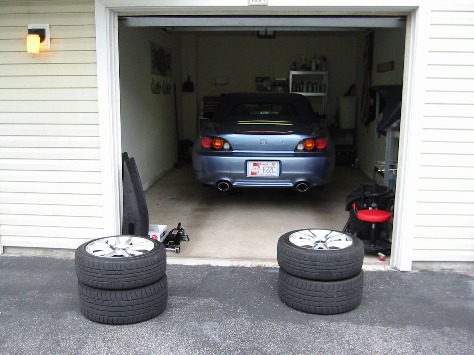

The first step was getting the car up on 4 jack stands. I had to drive the car up on ramps to get it high enough but it wasn't hard to get the car up with 4 jack stands under the frame rails.
After the car was up, I had to clean the calipers. I drained the included brake cleaner, which did an OK job. Then, on a hunch, I broke out some NevrDull metal polish material, and surprisingly that stuff did an even better job. The calipers were actually a little shiny.
Now I broke out the paint. When I opened up the gold paint, I new right away it would be just fine. They really should call the color "bronze" or just "shamelessly copied from Brembo gold". Pretty much exactly what I was hoping for. I taped off with painter's tape, and then I put on a total of three coats. You have to wait 15 mintues in between coats, but it took longer than that to do all 4, so I just went around the car 3 times. I think two coats would have been totally sufficient, but there was enough paint for about 5 coats so what the heck. The paint gets thicker as the epoxy/resin starts to harden. The final texture is almost smooth...like it was powder coated.

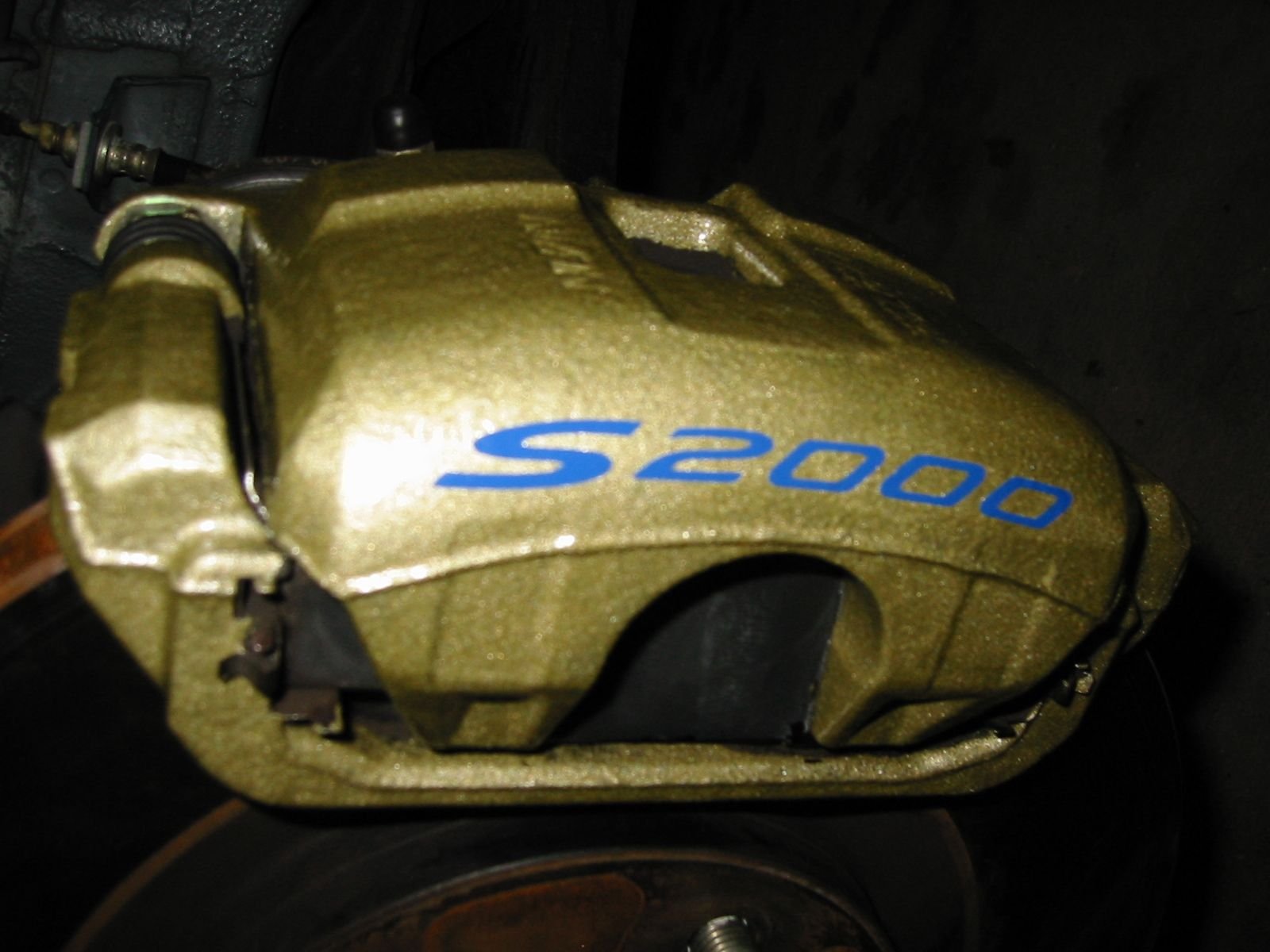

I then let the car sit for 24 hours per the directions. I went out this morning, took the tape off, and put on the caliper decals. On the rear, I just put the "S" on as there isn't room for the smaller S2000 decal decalgirl gives you.

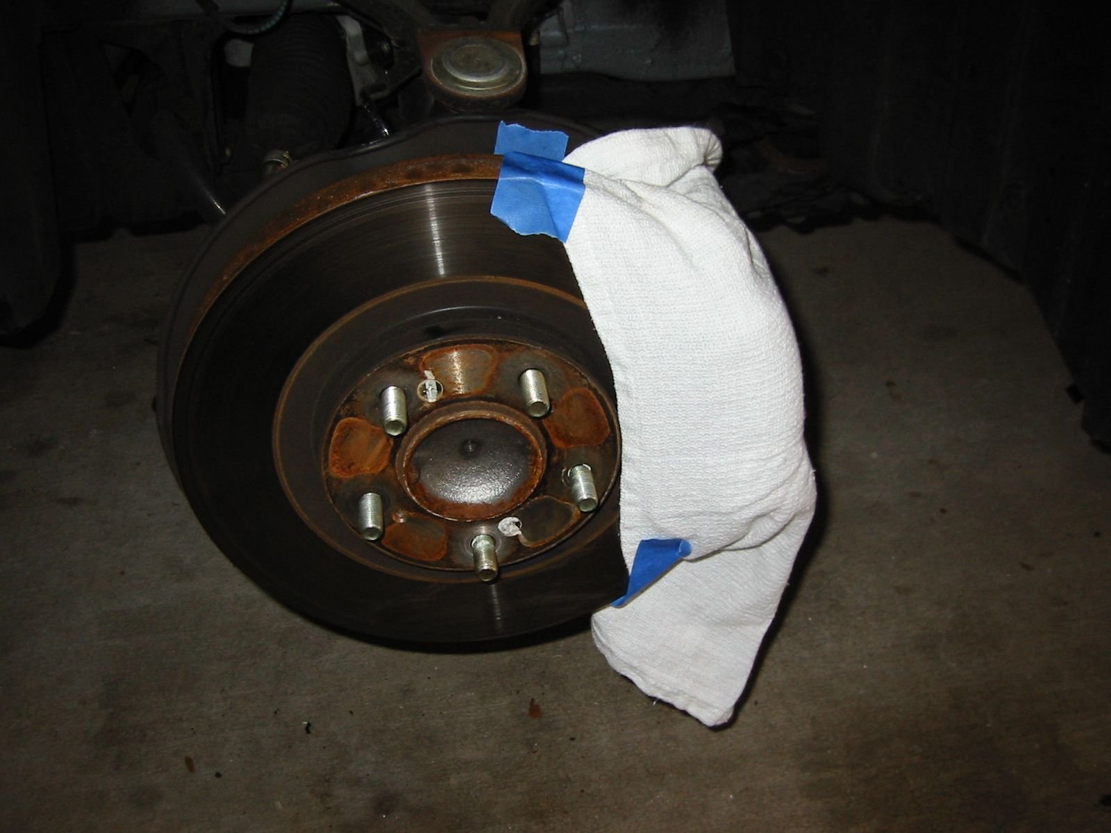

That done, it was time to put the wheels back on. Having read a ton of posts on here about people chipping the paint off the caliper with the rim, I decided to cover the calipers with a rag when putting the wheel back on.

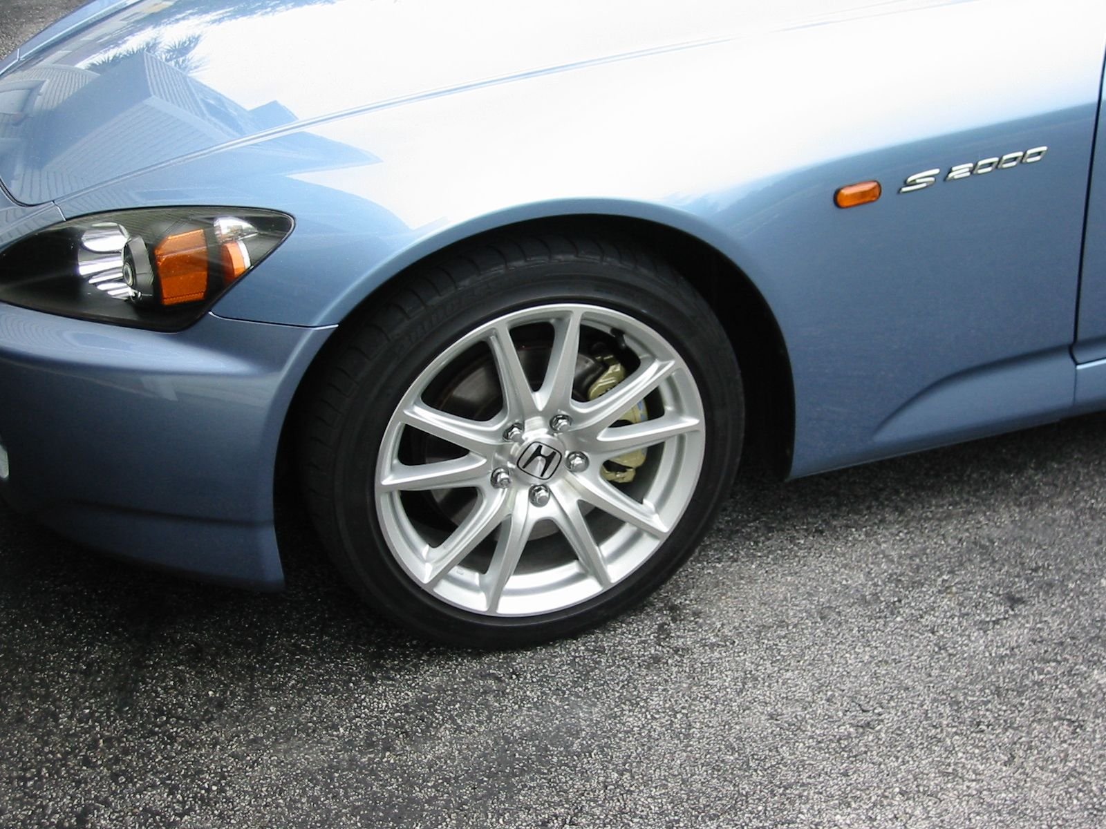

OK well if you're still with me here are the finished products:
Overall I am very pleased with the results. The color is subtle enough that this almost looks OEM. I definitely didn't want flashy calipers on a Suzuka, and thankfully they aren't. They really hide behind the OEM 17s anyway.
Opinions are welcome...if you think it's terrible let me know so I can fix it! I still have the silver.
