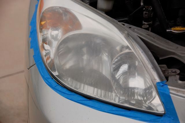

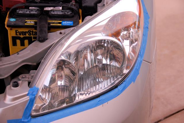

I tried a product from Advanced Auto on the headlights of my Toyota Matrix today. The car is a 2003 with about 110,000 miles on it. I have seen plenty of cars down here with lights that looked as bad or worse so I thought I would share the results. Kit cost $20; Process took about a half an hour.
Lights started looking like this.
and finished looking like new

Product Name was Crystal View Headlight Restorer
The process was
wet sand 3 min
wipe clean
wet sand (finer paper) 1 min
wipe clean
buff with solution a
wait 5 min
wipe on solution b
wait 5 min
wipe on solution b
wait 24 hrs before washing car.

Yes, I have been looking for a good product for a while. This is the 3rd time I have tried out a product like this. I can definitely say this is the only one that has left the headlights looking as good as new.
