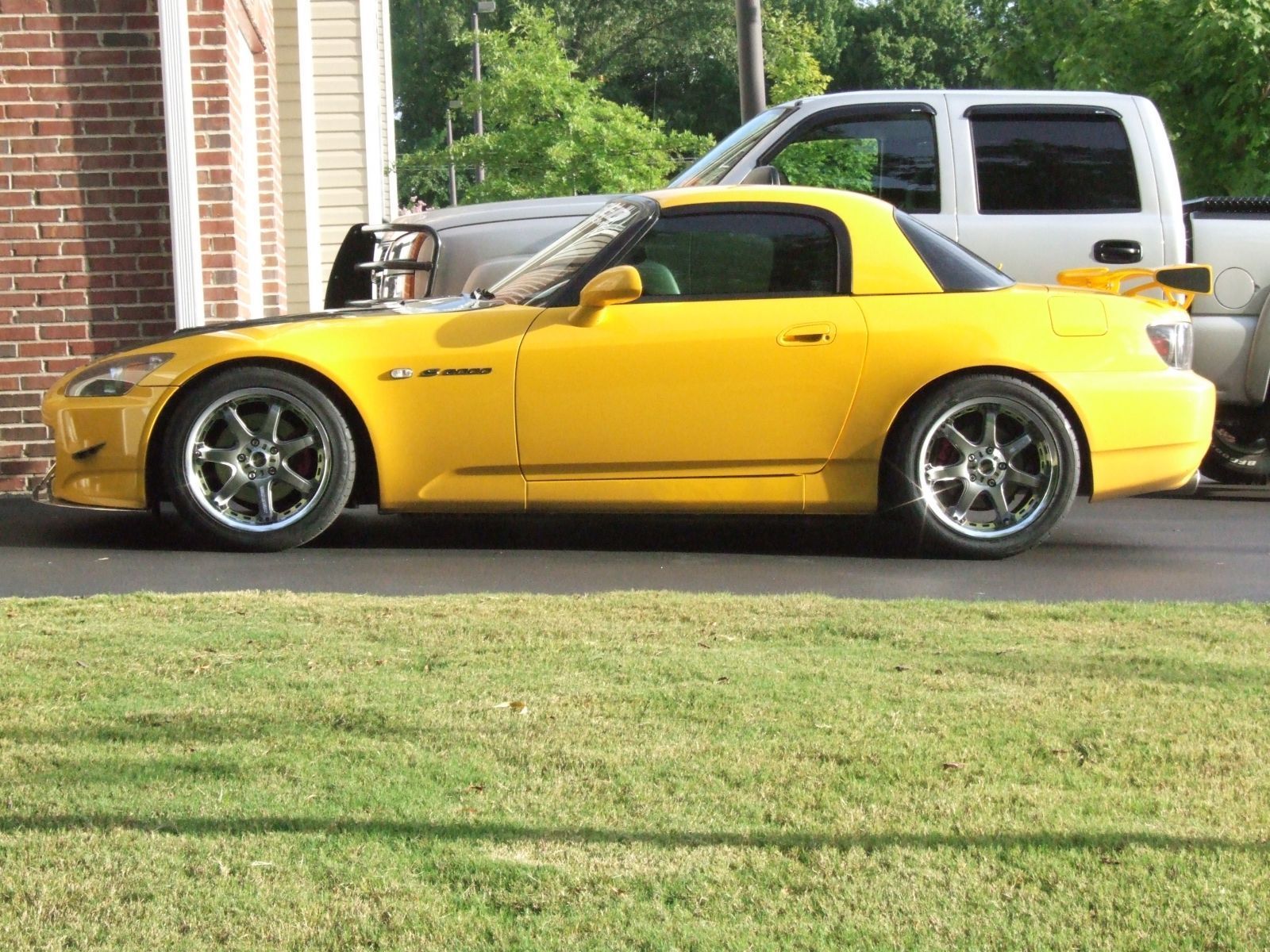

for my Florida guys
I miss FL after moving to AL
17x8+49 225/45 2"lip
17x9+49 265/40 2.5" lip
rear fender rolled and bumper bracket mod
Stock geometry on the rear
.25deg more camber on the front for more turn in grip
no rubbage before the camber adjustment
Lowered 1.2" in TEIN springs

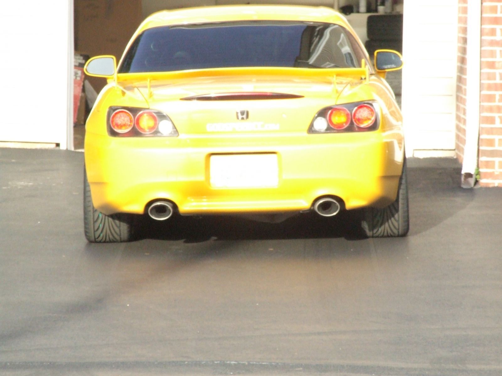

overexposed intentialy to show width of rear tires

damn you got some thick ass tires!

Was the smallest side wall tire I could find for the rear being a 265.
But being I wanted more rubber on the road I had to sacrifice a bit of looks to get there.
And stayed with a 17 to help keep the weight down
The front were sized appropriately to prevent then ABS from freaking out when on the track due to different rotation speeds when at the extreme of breaking force/tire cohesion.
+ the roads are bad up here in north AL to many post holes that I have seen compress a 225/255 setup on a 18 and either bend the rim or even crack it.
I have buddies that have taken advantage of a law up here that if the grade of a hole or step up between pavement sections is = to or greater than 2" then state must reimburse the driver the cost of the wheels/tires and any installations costs.
I looks good in person the pictures do make the side walls look BIG
I have fond the side wall of the T1R
