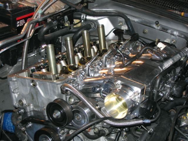

Thanks Jeff. The BDL doesn't come mirror-finished, but it's pretty soft aluminum so about 15 minutes on the buffing wheel is all it takes. If you have a chance, can you take a pic of the port on your intake manifold where they matched the TB? I'm just curious how they did it b/c when i bored mine out to 70mm there really wasn't much material left between one of the studs and the port.

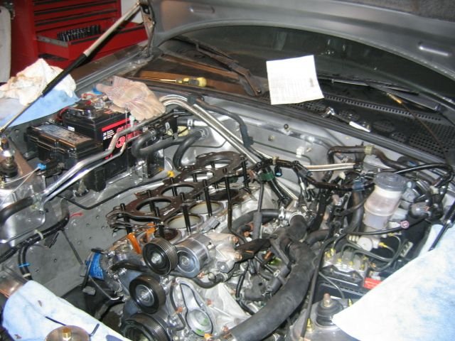

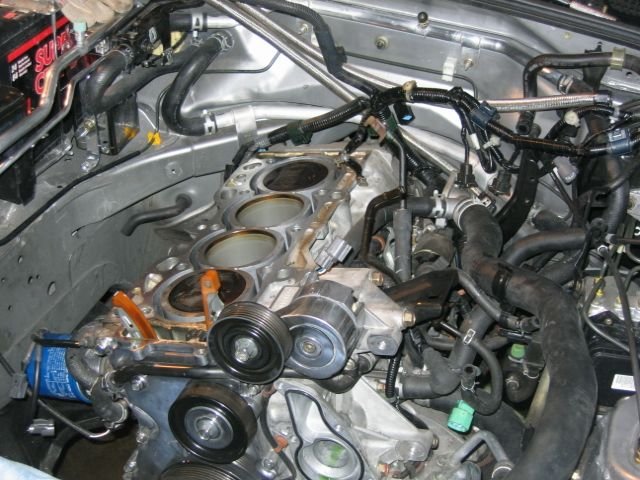

Well just did the head gasket and studs (actually Todd from 2NRWERKS did most of it while i watched; big to Todd on this) :
In case you ever wanted to see your motor w/ the head off:
ARP head studs installed and 3mm gasket (3mm doesn't sound like much, but in person this thing is thick!):
Head back on, waiting for the cams:
I'll post more as things progress. This was a major step though as it's been holding everything else up.
