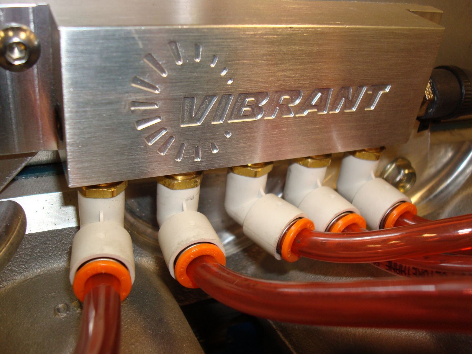

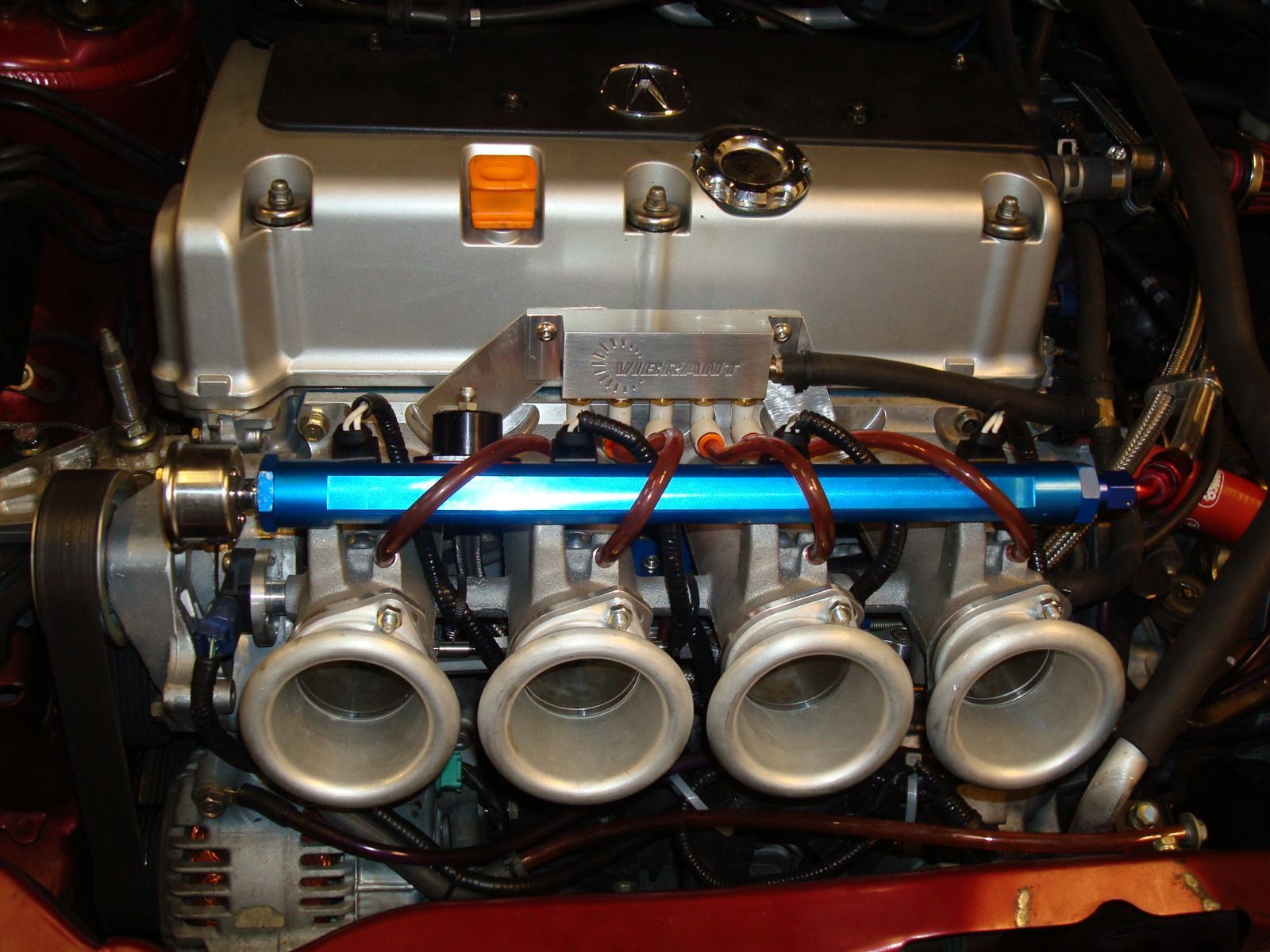

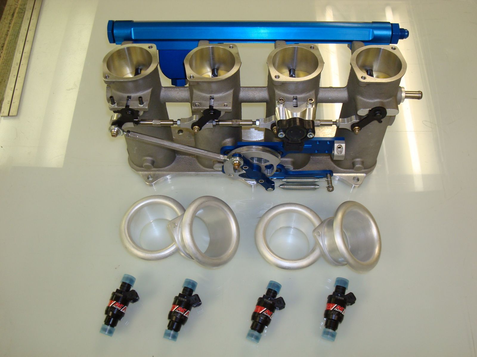

With the ITBs we had to elimanate the power steering pump and relocate the resivour towards the firewall. We also had to purchase an idler pulley off of an '07 Civic Si to take the place of the power steering pump. We also had to install a fuel return line since the RSX does not come with one from the factory. We did the fuel lines in staineless steel braided -AN6. Also the ITBs have vacuum ports on each runner. These needed to be run into a vacuum block which we choose to do out of 6mm air pnuematic fittings and transparent red hose to add a custom 2NR Werks look. To add to the mods this car sports Tein RA coilovers with EDFC controlls, DC Sports Race header and beautiful 18" wheels with a 3" lip. Dyno was not complete, but we estimate to be somewhere north of 250hp.
All this was a custom setup on this race version of the TWM ITBs not intended for street use. I have to say it tested our skills, but never got the best of us. Andy was responsible for most of the custom work on the ITB setup. Sometimes I heard him inventing curse words that I nerver heard before, but understood the meaning of. Can you say VTEC (in a yelling voice) Well that is what this beast sounds like. I will post video for you to see and hear soon.
