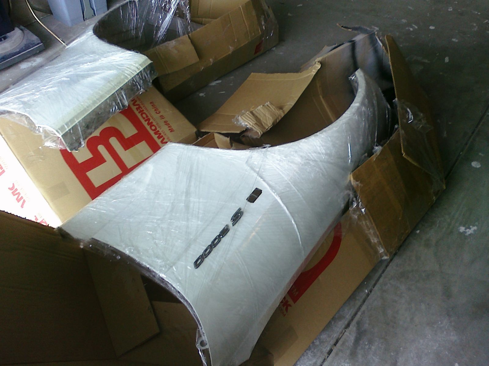

Just a couple of pics of the fenders still in wrapping.
And my AP1 front bumper (already sold) i picked up today from stephen vincel, im gettin the S back tmw morning!!
I didnt get time to shave the fenders, and I got a heat gun. Is that going to be way to hot? and Should I hit the heat from the back of the fender or on top of it facing the s2000 logo? Also Picked up some Automotive formula Goo Gone from Auto Zone today. I'll post pics later and let you guys know!

Be careful with a heat gun. It may get to hot. Pull back at least a few inches. Hit it facing the logo, shooting the heat down on it
