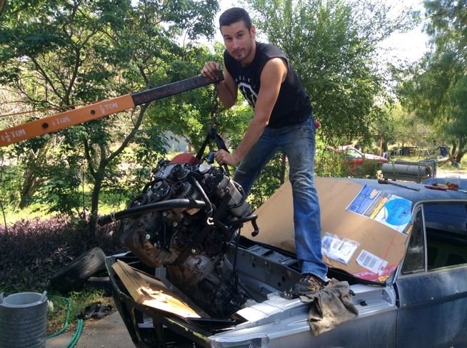

Sending the rear subframe off to the boys at catuned
Returned, powdercoated, and now e30 differential compatible
A better view of my reworked suspension
The car's original color and 40yrs worth of grime
Subframe/differential reassembled
Front subframe & rear control arms powdercoated
E30 vs 2002 diff.
Much better!
New rear diff installed
We're all done underneath
Now to start working on the top end of the car

Default More pics IV
Clearance!
Home sweet home
S2000 pump in a 2002 tank
...with a few modifications
