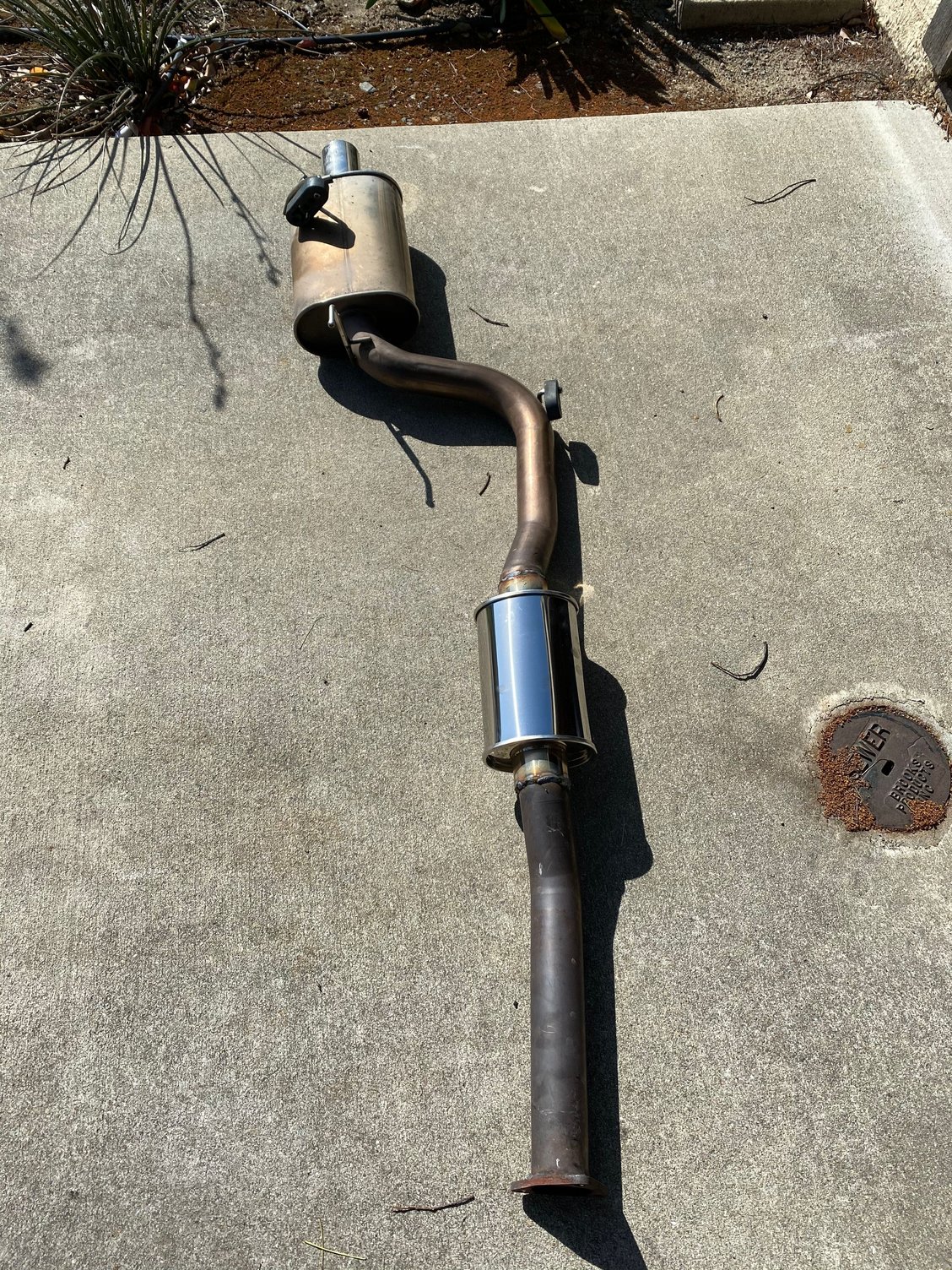

Someone asked me how the 70mm ASM sounds with the resonator replaced so I figured I'd record the sound and share it for anyone else interested.
Here is how the exhaust looks after the resonator was replaced. It's not pretty but it works.
Old Jun 1, 2020 | 12:14 AM
  #156
jiepo's Avatar
Joined: Aug 2018
Posts: 198
Likes: 35
Dam it sounds significantly louder than my 70mm S-Special + Berk 70mm HFC
