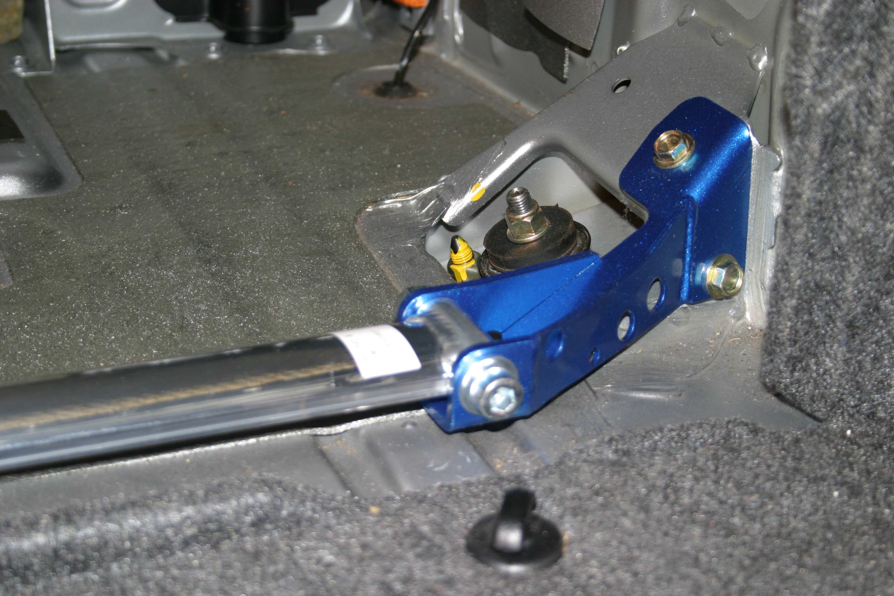

should look like this when installed, you dont have to touch the fuel neck for the install:

i cant see what you are talking about... have any bigger pics? lol.
Maybe he cant reach the top side one though with his tools?

pics are from a post here on the forums. scroll left and you'll see it.
the stock rear STB does have to be removed in order to install the new bar

i was being VERY sarcastic about the size.... lol i did see it.
